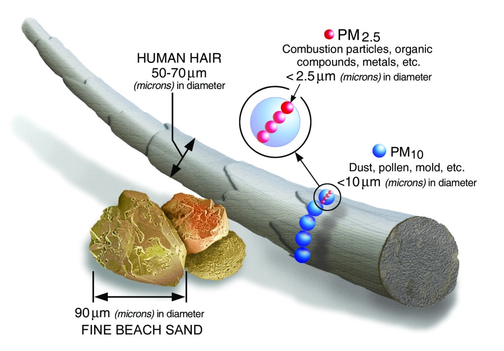

Fine particulates, much smaller than a human hair, can bypass the body's filters and enter the bloodstream.
Fine particulates — the tiny particles known as “PM2.5,” measuring 2.5 micrometers or less in diameter — are a worldwide killer. The micro-sized particles can avoid the body’s defenses and enter the bloodstream, and they carry an increase to the risk of asthma, heart attack, and stroke. In a multimedia story, The New York Times graphically displayed the concentration of PM2.5 in some of the world’s most polluted cities, along with a drop-down that lets you compare those extremely polluted locations to your own location (see: “See How the World’s Most Polluted Air Compares With Your City’s,” by Nadja Popovich, Blacki Migliozzi, Karthik Patanjali, Anjali Singhvi and Jon Huang).
