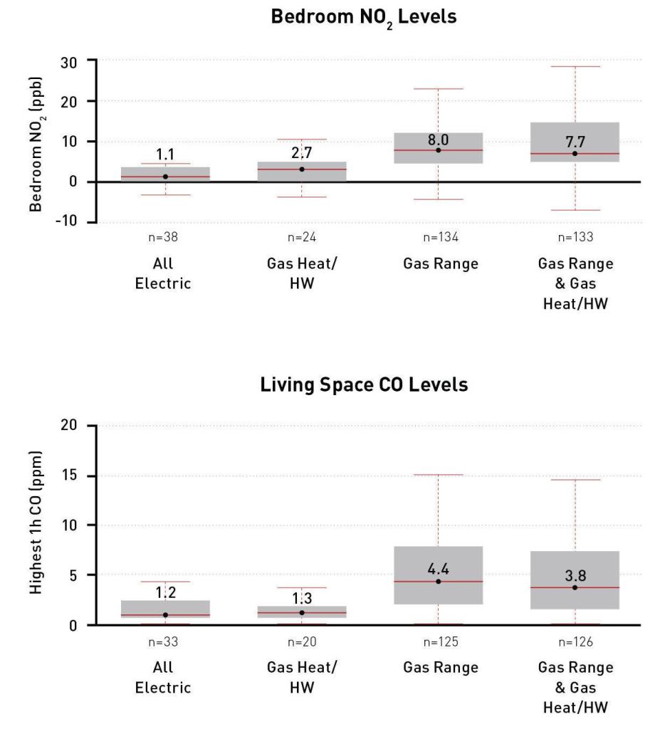

If cooking with gas is polluting your house, one easy answer is: Don’t cook with gas. Singer’s team measured CO and NO2 pollution in 350 California houses, and they found that houses with electric ranges showed much lower levels of CO and NO2 than houses where people cooked with gas. In homes with gas furnaces, it was the cooking—not the furnaces and water heaters—that created the pollution. The data also showed that NO2 wasn’t confined to the kitchen, but spread quickly to bedrooms as well.

Chart data: Adapted from Lawrence Berkely National Laboratory
