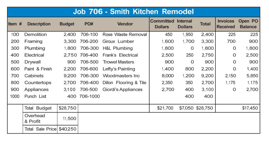

A purchase-order system allows you to keep track of a job’s expenses. All “committed” costs — essentially subcontractor payments and material purchases — receive a PO number, which gets plugged into a basic spreadsheet like the one shown here. As the job progresses, you can compare invoices received with what has been budgeted.

To use the PO system, go through your job budget and determine which line items are committed costs and which are internal. Then issue a PO number for each committed cost and set up a spreadsheet — like the one shown on the previous page — so you can tell as the job progresses where you stand against budget and where you have money left to work with.
Say you exceed your labor budget for demolition. Since it’s early in the job, you can still make up for this on one of the other phases — as long as you use internal money. You know, for instance, that there’s unspent money set aside for the cabinets and you don’t have to pay the balance for them until near the end of the job. But the spreadsheet makes it clear that those dollars are spoken for and you’ll have to find the savings elsewhere.
A simple kitchen remodel like the one in the sample spreadsheet uses several suppliers and subs. Each cost is assigned a PO number — based on the job number and phase — that should be given to each sub or vendor and to any carpenters who might be purchasing materials.

The PO system also eliminates another common problem: overpayments. Let’s say a sub has a contract for $8,000 and bills for $4,000 at the beginning of the job, but doesn’t get paid. Later, at the end of the job, he sends a second bill for the full $8,000. The bookkeeper — who in this scenario doesn’t have a PO number to compare the bills against — pays the sub $12,000. By the time the contractor figures out what happened, he may not be able to get the money back. An updated PO spreadsheet would have made it clear how much the sub was owed and how much he had billed for.
