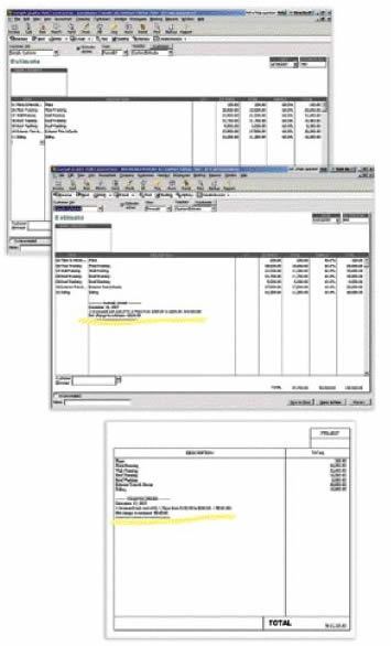

New features in Premier for Contractors — like the ability to “automatically create change orders, invoices, and purchase orders from estimates” — sound very exciting. In actuality, the change-order option is a bit clunky.
Let’s say you go into the original estimate, which has a line item for Plans at $100 with a markup of 60 percent, showing on the printed estimate as $160. If you alter the cost for Plans to $200, QuickBooks will automatically apply the 60 percent markup. Now your line-item charge-out price (what the customer will see) has increased to $320, a change of $160. When you save the revised estimate, you will get an option screen that invites you to let QuickBooks add the change order. Any time you edit the cost of an item with a markup, the Intuit-supplied message will be confusing. The canned comment will read, “Increased unit cost of 01.1 Plans from $100 to $200. (+$160.00) Net change to estimate +$160.00.” This sticks your markup right under your customer’s nose while simultaneously confusing him. Does the change cost $100 or $160? If $160, why mention $100? (It should be noted that if you are estimating an Item for which there is no markup, this is not a problem.)
If you are using the “automatic change order” option to save time and don’t mind if your customer sees what QuickBooks arbitrarily adds, you’re okay. If you prefer to bury your markup, then this option may not work for you unless you go in and edit the text yourself. But how convenient is this “time-saving” feature if you have to edit the result every time?
