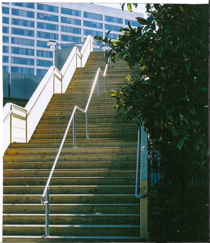

The landing framing, decking, stringers, risers, and treads on this 2001 project were all pre-cut off-site and assembled on site to overcome limited security and the lack of electrical power.
Bobby Parks The landing framing, decking, stringers, risers, and treads on this 2001 project were all pre-cut off-site and assembled on site to overcome limited security and the lack of electrical power.
