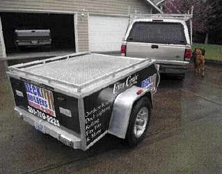

My wife, Linda, suggested using a small trailer. Although I hate driving with a trailer, the idea had merit. I could hook up the trailer when going to sales appointments, but I wouldn’t have to drag it around with me all the time. It would hold all the samples and keep them clean and organized.
I began looking at trailers, but none of them fit my needs: They were too big and too expensive. Finally, while driving one day, I passed a couple of motorcycles, and behind one of them was a tiny trailer. Wow! It looked so cool!
Back to the trailer dealer I went, but this time I asked about what the motorcycling world calls a tow-behind. Sure enough, the dealer had them, and now I have one, too (Figure 1). My little trailer is made of aluminum and has a hatchback lid that locks. It’s 4 feet wide, 6 feet long, and 22 inches deep. With some modification to the hinges, I can take the lid off. Inside, I built racks to hold everything that I want to bring to sales appointments.
Figure 1. Sales samples stay clean and organized in this customized tow-behind trailer, helping the author to project a professional image.

My presentation setup includes 10 decking samples — six composites and four woods — each comprising three 25-inch-long boards mounted to 5/8-inch plywood that has been painted black. I made the plywood larger than the decking to create a handle and to allow room to set a railing sample next to the decking (Figure 2). I have eight railing samples, 24 inches wide by 19 3/4 inches tall, mounted on deck boards.
Figure 2. With the trailer lid open, the authors show how a potential client can examine her decking and railing selections — and stay dry in the Washington rain.
I also have a fiberglass pergola sample from Arbors Direct (800/930-7495, www.arborsdirect.com), two samples of sub-framing (standard and upgraded), and a waterproof-membrane sample. A display case of Highpoint Deck Lighting (888/582-5850, www.hpdlighting.com) plugs into the 12-volt system in the trailer.
In addition, I carry literature about the decking products I offer and a photo album of my work. To top it all off, I have a big golf umbrella to keep Washington’s regular rain off the clients while they view the samples. I spent $2,500 and put in 80 hours to get it all together, and boy, am I glad I did.
The trailer tows, hitches, and unhitches easily, and can be moved around by hand. I use it for only one purpose and I love how it keeps everything clean and organized. My sales presentations are more professional, and the response from clients has been even better than I expected. My samples are big enough to give a good visual representation, and my clients have emphatically expressed their appreciation that they can actually see what each choice would look like.
