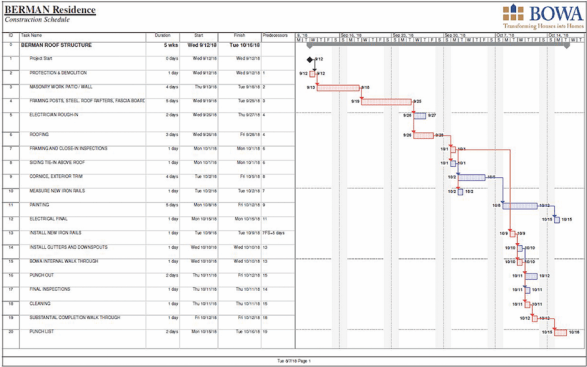

It’s the production manager’s role to create a master schedule for each job. We use Gantt charts, which we usually create using Microsoft Project (though for simpler projects, other methods are fine).
Gantt Charts and the Critical Path
Gantt charts show the phases of a project as they progress through time, and they illustrate which ones need to finish before another starts, so they make a great visual guide to the whole project. For typical construction projects, calendar days are set out left to right. Construction activities are written in order down the left edge. The days we plan to do each activity are shown as a line or block on the calendar days, so a long activity will have a long bar, and a short one a smaller bar. When one activity has to finish before the other starts, they don’t overlap, so the “Foundation” bar ends before the “Framing” bar starts. The result is a set of lines generally running from top left (first activities at the beginning of the project) to the bottom right (punch-out at the end).
Normally, our activities are defined by the work that a crew or trade will do at one point, such as “plumbing rough-in,” “tile kitchen floor,” “main roof shingles,” and so on. The plumbers will be on a schedule more than once: “Ground works” is its own line because it happens separately from rough-in and final trim, which each get their own lines as well.
The “critical path” is the chain of all the activities that have to finish before each other to get the whole project done, and these tasks are the ones that need the most attention as we work the project. Of course, everything needs to be done by the end, but there are often a few activities that can happen in a wide window of time, because other tasks don’t depend on them; these are not on the critical path for the project.
We use Microsoft Project for our Gantt charts, but it’s overpowered for what we do with it. We sometimes use hand-drawn paper versions or use X’d out cells in a spreadsheet to make a simpler version, which is perfectly adequate for many jobs.

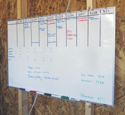

At least once a week, the production manager visits each job and meets with the project manager for an update. To prepare for this meeting, the project manager creates a look-ahead schedule each week for the next two weeks. This two-week daily schedule organizes the conversation between the project manager and the production manager. Taking a half hour to write all that stuff out and see what is going on in the next couple of weeks prompts us to communicate: It reminds us that we need to be calling all our subcontractors two weeks before we want them, to remind them that this is when we need them. This practice also helps remind us about materials that need to be ordered or selections that aren’t complete.
In fact, a lot of us, including myself, have found that two weeks is not far enough out in advance for a look-ahead schedule. For example, some material orders require a much longer lead time than two weeks. I like to look ahead at least three weeks, and the PM on a complicated project may build a look-ahead that is as long as six weeks forward.

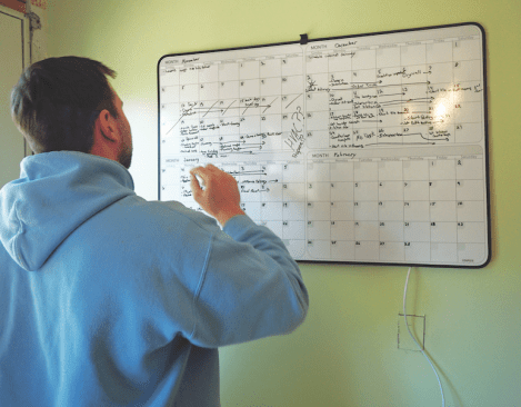

There are many ways to do that; I’ve made a look-ahead calendar out of a piece of plywood and used sticky notes to fill it out, so that I can move the stickies around as time passes. Some of our PMs use a whiteboard and erase each week as it goes by, wrapping back around to the top when they run out of space at the bottom. Large desk-blotter calendars are popular, too, because each day has plenty of room to write in. Some use computer calendars as well.
