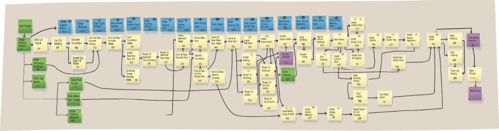

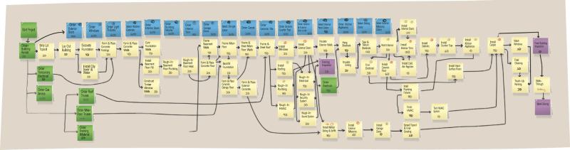

To schedule his jobs, the author writes each task on a Post-it and then arranges the notes on the wall. The tasks are color-coded: yellow for work activities; blue for owner decisions; green for materials that can be ordered without owner involvement; and purple for interactions with the bank or building inspector.

Once all the activities are written on Post-its, I tape a large strip of paper (brown parcel paper works well) onto the wall and begin to stick notes to it. The paper is there because later on I will draw lines between the notes. My goal during this phase is to put the tasks into a logical sequence. The end result is a flow chart of basic activities: frame the walls, frame the roof, install roofing, install siding, and so on.

To make the ordering activities stand out, I write them on a particular color of Post-it. The ordering activities that involve client decisions go on blue Post-its; when I look at the flow chart and see blue, it reminds me that I need to get the client to decide something a certain number of days before some other activity can happen. The ordering activities that don’t involve client decisions — ordering roof trusses, for example — go on green Post-its. Each ordering activity is linked by number to a corresponding work activity. For example, the 14th ordering activity I wrote down was “Select Interior Paint Colors,” so I wrote the number 14 on that blue Post-it and on the yellow Post-it for the task “Paint Interior.” Tasks that involve the building inspector or the bank are written on purple Post-its.

Once the project is broken down into sufficient detail, I try to find activities that can happen concurrently. For instance, I could schedule roofing at the same time as plumbing and hvac rough-in. When activities are scheduled concurrently, the Post-it notes split into parallel lines of tasks.
To avoid confusion, I draw lines between the notes to indicate where they belong in the sequence of activities. There’s nothing unusual about scheduling tasks concurrently — we all do it. The difference in my method is that I plan for it consciously, which allows me to squeeze the maximum amount of time out of the schedule.
If I don’t like the way the schedule is shaping up, I can rearrange the notes until I’m satisfied that the activities are laid out in a logical way. Then it’s time to calculate the duration of the project by adding up the durations in the longest line of notes.
