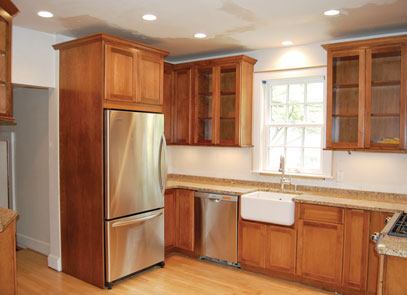

We run a full-service remodeling company with a division solely dedicated to kitchen and bathroom remodels. Even in the current tough economy, we’ve found that kitchen remodels are still selling. However, homeowners are watching their budgets a lot more closely than they were a couple of years ago. Today, a $90,000 custom kitchen is far more the exception than the rule.
In response to a tighter market, we created our Express Kitchens program, a packaged approach that streamlines the kitchen renovation process from start to finish. Express Kitchens start at $29,000, with the average cost at about $34,000. It’s a great solution for clients on a tight budget or a tight timeline who nonetheless want a quality job based on limited but proven product choices.
Pull and Replace
At their core, these kitchens are pull-and-replace jobs that take about two weeks from start to finish. We don’t change the location of the sink or the appliances. There’s no demolition of soffits or walls and no door or window revisions; no hvac work and no additional electrical circuits, outlets, switches, or lighting. We restrict cabinet rearrangements to the existing layout; new cabinet selection is confined to what will fit within the previous limitations. For example, two 30-inch base cabinets may be replaced with an 18-inch base, a 24-inch base, and another 18-inch base without altering the general layout. Basically it’s a size-for-size swap. The idea is to keep the process streamlined and simple while significantly improving the space and giving it a fresh look.
During the first visit we confirm that the project qualifies for this approach. In other words, we make sure the client understands that this is truly a pull-and-replace project, with no changes to the kitchen’s footprint. If the desired alterations are too complex, the renovation will no longer fit into this program. In such cases, the discussion often progresses to a custom kitchen job and a larger contract. Because it shows sensitivity to budget, presenting this packaged alternative builds trust.

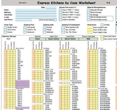

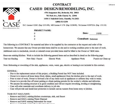

During the second visit with the clients, we work on finalizing selections. When done, we can price these projects in the clients’ home in about 30 minutes and provide them with a fixed-price contract on the spot. This is possible because we show up armed with a complete database of installed costs for every selection made. In developing the Express program, we assembled our salespeople, project managers, and craftsmen and isolated our processes and systems for pricing, material options and selections, labor costs, and contract generation. Then we consolidated all of the core pricing, selection options, and layouts in a customized Microsoft Excel spreadsheet (see example).
Changes. The software allows us to change selections at the click of a button: Change the countertop from solid-surfacing to granite, for instance. Or change from raised-panel oak to Shaker-style cherry. Since the price of the project is always visible to the clients, they see the immediate impact of their decision and how much it raises or lowers their investment.
The spreadsheet is set up to automatically generate the contract based on the data entered during the selection process. But the software — though it does speed the sales process — isn’t essential to selling these kitchens. What matters most is that we limit selections to those products and processes we are completely familiar with and have firm pricing for.
