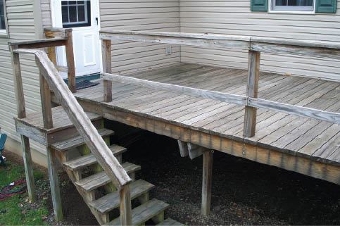

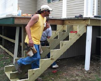

Stairs can be tricky (Figure 8). If you’re planning to save the existing stringers, you need to make sure that the current tread depth will work with the width of the new decking. When stairs don’t work well or don’t meet code, I include building new ones in the contract.
Figure 8. Old stairs are often in rough shape, don’t meet current codes, or aren’t configured to accept modern synthetic decking. Replacing them is a common part of a deck remodel.
