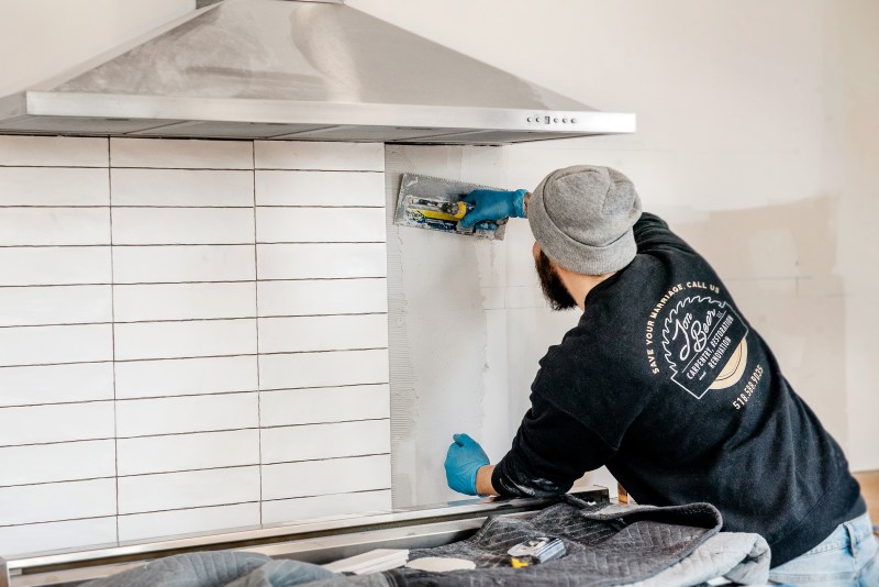

In this photo (above), the author tiles a backsplash. (The completed kitchen is shown further down in this article.) . His company, Jon Beer Contracting, self performs almost everything it can to control quality.
Image courtesy of Jon Beer Contracting and Lubin + Paramo Studio
In this photo (above), the author tiles a backsplash. (The completed kitchen is shown further down in this article.) His company, Jon Beer Contracting, self performs almost everything it can to control quality.

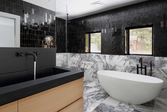

On this high-end bathroom gut remodel, the author said, "I wish this job had been cost-plus. This job was early on in my career and it took hundreds of hours to complete. Cost-plus shines on jobs like this where we have a lot of high-end details and fixtures that we had never done before. Instead of relying on my guess for how long it should take, we could have simply been tracking our hours and billing for them."
courtesy Jon Beer Contracting and Hendley & Co

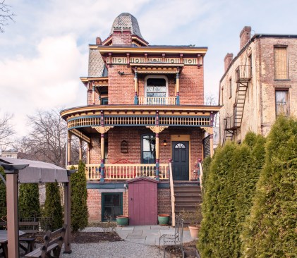

The author spent 13+ weeks rebuilding this Victorian porch (photo above) on a fixed price contract. Everything from rot replacement, to new ceiling, turning new parts on the lathe, building a curved LVL and topping it off with a six-color paint job. This was the first job he did where he realized that cost-plus could be a better way. He ended up having to negotiate a final payment with the client and took a hit in order to mediate the situation. It was a big turning point for him, as he realized that, at the very least, all the historic restoration work his company did would be negotiated cost-plus going forward.
courtesy Jon Beer Contracting and Lubin + Paramo Studio
The author spent 13+ weeks rebuilding this Victorian porch on a fixed-price contract. Everything from replacing rotted parts, to putting in a new ceiling, turning new parts on the lathe, building a curved LVL, and topping it off with a six-color paint job. This was the first job he did where he realized that cost-plus could be a better way. He ended up having to negotiate a final payment with the client and took a hit in order to mediate the situation. It was a big turning point for him, as he realized that, at the very least, all the historic restoration work his company did would be negotiated cost-plus going forward.

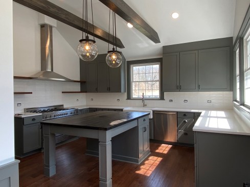

A kitchen remodel (the completed job is shown in process in the lead photo above) completed by the author using a combination of fixed-price with hourly extras. This job pricing strategy was a step in the right direction, and proved a marked improvement over the outcome of the porch restoration shown above, but it still presents risks when things don't go as planned.
The author completed a kitchen remodel (also shown in process in the lead photo, above) using a combination of fixed-price with hourly extras. This job pricing strategy was a step in the right direction, and a marked improvement over the outcome of the porch restoration shown above, but it still presents risks when things don't go as planned.

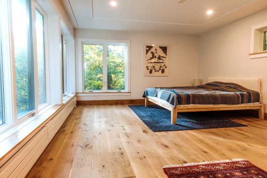

This completed bedroom (photo above) was part of the remodel of a two-story addition, done fixed price with hourly extras. Because of adverse weather (working outside through the winter) the author's company lost out because they had more labor involved than they had originally bid.
This completed bedroom was part of the remodel of a two-story addition, done fixed price with hourly extras. Because of adverse weather (working outside through the winter), the author's company lost out because the job required more labor than what was included in the bid.
