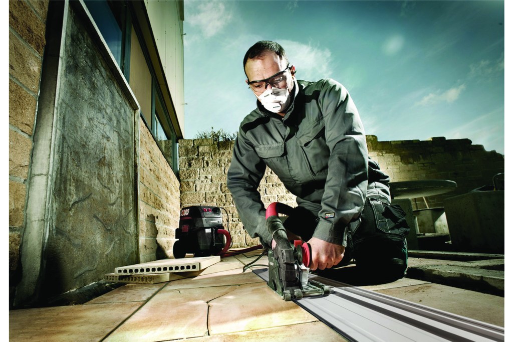

Respirators are not enough. OSHA  offers two compliance paths: “Table 1”  from the rule, and “Objective Data” based  on testing performed by respective tool  manufacturers. Respirators aren’t often  needed within either compliance path,  while dust-control methods almost  always are.
When a respirator is required, Table 1  indicates whether it needs to be rated  APF 10 or, in some cases, APF 25. Some  dust-control methods, like the grinder  shroud and dust extractor shown here,  might still require the use of a respirator  depending upon the duration of the task.  Grinder shrouds, like this one from Metabo,  are becoming readily available from most  power-tool manufacturers.

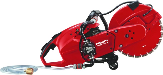

The most straightforward  path to compliance when you’re cutting concrete  or masonry is to use a wet cut-off saw. The  Hilti DSH-700 (above) has an add-on water pump  feature that complies where running water is
not available.
The most straightforward path to compliance when you’re cutting concrete or masonry is to use a wet cut-off saw. The Hilti DSH-700 (above) has an add-on water pump feature that complies where running water is not available.
MOST SAWS REQUIRE WATER
Table 1 spells out several cutting tasks that require everything from handheld cutoff saws to riding saws. To be compliant, no matter what diameter blade you’re using, and no matter if you’re cutting indoors or outdoors, the rule requires that the saw be equipped with an integrated water-delivery system that feeds water continuously to the blade. An important note here is that the delivery system must be specifically designed commercially for the type of tool you’re using. So, you can’t make jobsite modifications to tools or use methods like spraying the blade—or the concrete, block, brick, or whatever material you’re cutting—with water and be considered in compliance (or even protected).

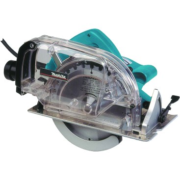

Cutting fiber-cement products like  siding and backerboard should be done outdoors  in a way that does not create dust. If a saw is used, it must be equipped with a dust shroud, like the one on the Makita (above). A popular misconception is that the dust extractor in this scenario must be equipped with a HEPA filter; it  does not. But the extractor must be equipped with a filter that is 99% efficient or greater.

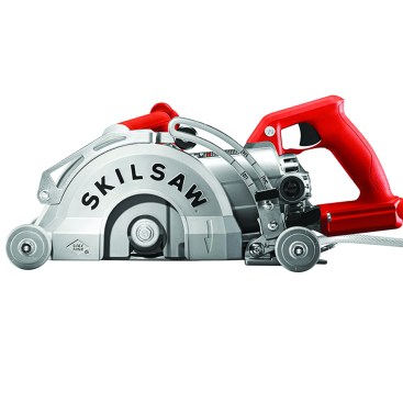

Skilsaw’s  Medusaw (above) complies with Table 1 when  used with its water-delivery system. But the saw  also complies via the Objective Data component  of the rule if used with a dust extractor according  to Skilsaw’s recommendations.
As you well know, commercially available saws are typically equipped with a hose connection. Skilsaw sells a saw called the Medusaw (now available as a walk-behind saw as well) that is a redesigned Skilsaw 77 equipped for cutting concrete and masonry. The problem here, as with any saw that has onboard hose hookup, is that it requires a water source.
There are systems available for when a water source isn’t readily present. Several manufacturers have a pressurized tank system for this purpose. Hilti has an add-on pump kit that can draw water from a large bucket. This works for a couple of the Hilti saws in situations when you don’t have running water.

Mortar removal is spelled out in its own step within Table 1—wherein you’re allowed to use a grinder equipped with a commercially available water-delivery system or with a commercially available shroud and dust-collection system. Most manufacturers that make grinders now have these shrouds and dust-collection systems available. You can purchase the shroud separately as a retrofit for many grinders—both cordless and corded. You can purchase it as part of a kit with a grinder, as well. For other tasks, like surfacing concrete or cutting tile, you can use either a water or a dust-collection approach. However, there are other parameters for both approaches, so be sure to read Table 1 carefully.
In either scenario, the dust-collection system must provide at least 25 cfm of air flow per inch of wheel diameter, have a filter that is 99% efficient or greater, and use either a cyclonic pre-separator or a filter-cleaning mechanism. Cyclonic pre-separators are becoming more widely available—though typically only worth an investment if you’re doing significant amounts of this work. Metabo, for example, has one coming out in April that is HEPA rated and costs $2,500. If you do only some mortar removal, cutting, or surface grinding with a grinder, or use a grinder to cut tile or fiber cement, a dust extractor with filter cleaning might be the most economical approach. Depending upon features, size, and other specs, you can purchase a dust extractor for anywhere from several hundred to a couple of thousand dollars. If the dust extractor doesn’t have automatic filter cleaning, look for one that has an onboard gauge that indicates when the system is getting full and needs to be cleaned.

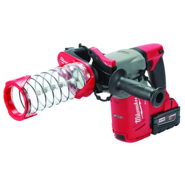

Several other tool manufacturers  offer inexpensive shrouds designed to contain  silica dust. When you’re drilling overhead, this  shroud from Milwaukee can be emptied and  reused, or the tool can be hooked up to a dust  extractor.

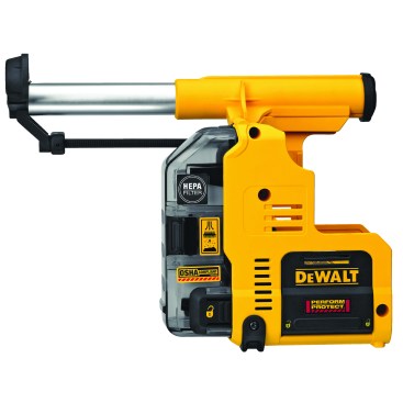

Most tool manufacturers offer Table-1- compliant, onboard attachments, like this DeWalt shroud, which is designed to contain dust, as well as pull dust away from the hole.

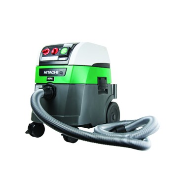

Hollow-core drill  bits (not shown) are also available that connect  directly to the dust extractor and remove dust as  the hole is drilled. HEPA-equipped dust extractors,  like this new model from Hitachi,  are available in various sizes and cfm ratings  to comply with Table 1.

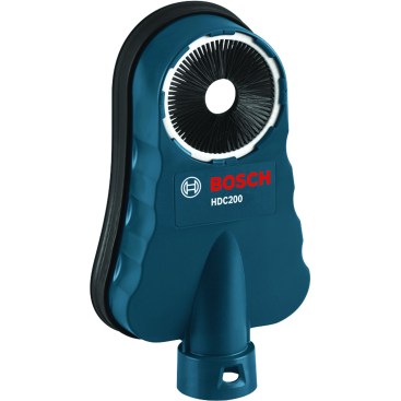

Other shrouds, like the Bosch,  hook up directly to a dust extractor. These shrouds  suction to the work surface, contain the dust, and  pull it away at the same time.

Dust shrouds that encircle the bit near the work surface are available from all of the manufacturers. These shrouds keep the dust from becoming airborne and connect to a dust extractor that’s equipped with a HEPA-rated filter. The shrouds adhere via suction directly to the surface being drilled once the dust extractor is turned on.
If you drill a lot of holes and have bought into a battery platform, or if you already own a cordless rotary hammer, there are commercially available shrouds that attach directly to the tool. These shrouds are like having an onboard dust extractor and include a filter. They are powered by the tool’s battery. Some manufacturer’s products are Table-1 compliant, while others comply with the OSHA rule by providing Objective Data about that specific setup.
