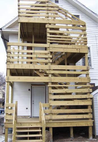

Once on site, I found a 16-foot-by- 8-foot three-story deck and stair assembly built in what I call “early paddock style.” The owner had hired a contractor to remove the old porches and build this new structure to serve as secondary egress (a required element in multi-family housing). Next, he intended to have the existing interior secondary egress stairs demolished in order to gain floor space for another small bedroom on each floor.
Unfortunately, the new deck didn’t meet code; in fact, it looked like someone had been trying to build a deck that violated every typical code requirement, starting at the foundation and continuing up from there.

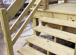

All five runs of stairs had rise and tread discrepancies and undersized landings, and two of the runs had headroom issues. The rises, whose heights are supposed to be within 3/8 inch of each other in each flight, were all over the place (Figure 6). On one flight, the rises ranged from 6 inches to as much as 7 1/2 inches. The risers were open, with more than a 4-inch space, and some of the treads were only 8 inches wide where R2 occupancies require 11 inches of width.
Figure 6. Stair rises cannot vary more than 3/8 inch throughout a flight.
The stairs had other code violations. There were no graspable handrails and the stringers were overcut (Figure 7). Plus, window glazing was located only inches from the ends of the stair treads (Figure 8); because of the lack of safety glazing, the window could be broken by a snow shovel, or someone could fall down the inconsistent stairs and be cut.
Figure 7. Overcuts weaken stringers and reduce the uncut portion to less than the code-required 5 inches.
Figure 8. Safety glazing must be used near stairs.
Fix: Rebuild stairs and landings to code, adjust header placement to create adequate headroom, close the open risers, add handrails, and add safety glazing to the windows (IBC Chapter 10 and S2406).

This deck was a study in what not to do, and I had no qualms about being the bad guy and red-tagging it to stop any continued use. The owner has been cited for building without a permit and is required to correct all violations before the deck can be used. Had the original plan been carried out – removing the secondary interior stairs after the completion of the deck – I would have been compelled to tag the structure “Unsafe” and relocate the third-floor tenants to temporary housing at the owner’s expense until the egress stairs were restored. Fortunately that phase had not begun.
Because he had a signed contract with a licensed contractor, the owner applied for reimbursement from the state contractor’s fund, which provides up to $15,000 to remedy unfinished jobs or poor workmanship. The money comes from a “home improvement licensing fee” attached to every building permit issued in Connecticut. The state will aggressively seek repayment from the contractor who did the work.
Although the owner now has a building permit to install a properly built multi-story deck, no remediation work has been performed to date. My last conversation with the owner stipulated that prompt corrective action is needed and that he can’t wait for reimbursement from the state. His immediate choices are fixing the deck or removing it; otherwise, the city will initiate court action that would include a fine, deck removal by a city-hired contractor, and a lien on the property.
