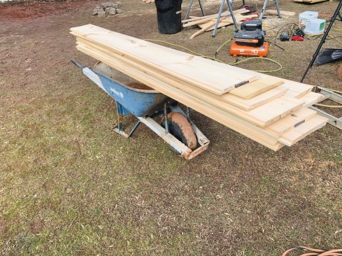

The ability to roll a stack of lumber around instead of moving it board by board contributes to efficiency. On uneven ground, a wheelbarrow can substitute for a cart or a dolly.

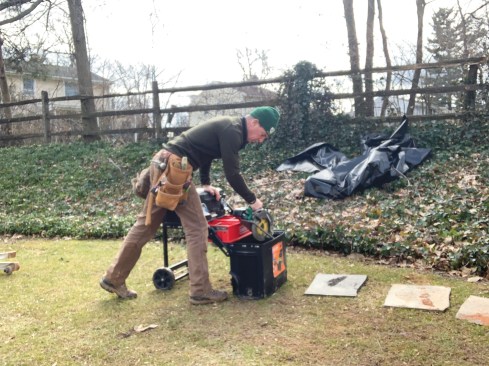

Carts. I don’t make any money moving stuff around. I make it installing stuff. One question I often ask myself is, “Will I have to move this twice if I put it here versus over there?” On basement remodels, the answer is almost inevitable: Yes, because if you put the studs and plates in the middle of the room, and the tile in the corner for later, where will you cut? Or where will the plumber put his stuff? Can the electrician reach the panel?
To make moving materials around easier, I make simple dollies using 2×4 lumber and 4-inch rolling/locking casters. Two will carry a mountain of studs, while one can carry a landslide of tile boxes. I’ve even put a site-built miter saw station on them and towed it around the room because cutting standing up is much easier than wrestling with a circular saw while hunched over and cutting on the floor, and faster than walking back and forth to sawhorses a million times. If something is in the way, the dollies allow me to roll it so that it is not in the way.

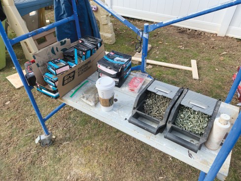

Even if not needed for working at height, a rolling scaffold offers a convenient spot for storing fasteners and other small items, and it can be rolled to where those items are needed.

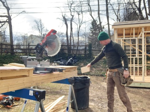

The second thing I set up is a trash can, which gives me a place to dispose of the packaging after I take the last bite of the sandwich or unwrap some door hardware. The other thing I do with the trash can—which usually lives at the end of my cut bench; more on that in a second—is put a bunch of bags in the bottom of it, then wrestle a bag around the rim. After the first bag is full and I remove it, I have to spend zero seconds wondering where the spare bags are. Grab and go.

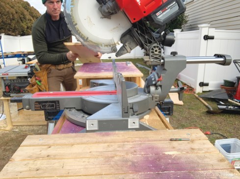

I know a lot of lone wolves like foldable, collapsible miter saw stands, but I’m not one of them. For all the efficiency they offer in the form of compact storage and roll-away transport, most offer stock support but no work surface. So I make my own miter saw tables, and while I’ve gone through a zillion designs (the current one is made from strapping and cost about 99 cents), what they all have in common is continuous infeed/outfeed. So when I’m installing crown, I can screw a cleat to the table top (because there is one) and cut material nested. I can hang my coping saw off a screw in the side along with the clamps I use to hold the piece in place while I cope. I also use the table’s edge to measure to short points. I just align the edge of the table with the short point, then hook the table and measure. Everything I cut off immediately gets thrown in the trash can that is placed right there.

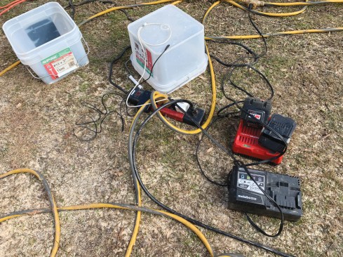

Storing items by categories, such as cords, chargers, and batteries, and storing them in bins makes it easier to track an item down.
A good example is my Craftsman trilevel toolbox. I can keep most of the everyday-carry deck stuff in one and roll it to where it needs to go in one move, not 35. I take the same approach with my service body truck. All the pneumatic stuff goes in one bin; all the clean-up stuff and the small vac goes in another; cordless tools, batteries, and chargers go in a third bin. The benchtop tools go in the main body of the van, and they’re a mess, to be honest, but it works.
