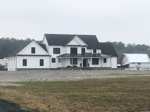

Stretching 80 feet across the front of the Maryland home that my company was building, this front porch was one of the home’s major design elements and would be highly visible from the road. As the general contractor, I knew the home inside and out. It was designed as an all-white, modern version of a farmhouse, with black doors and window frames. During construction, the owner and I agreed that a dark ceiling for the porch would help soften the contrast between the bright white exterior and the black accents.
The front porch and the porch ceiling are important design elements in this modern farmhouse-style home.
The house stands on a fairly exposed site, a working farm on Maryland’s eastern shore, between Chesapeake Bay and the Atlantic. So the ceiling would have to resist strong winds, humidity, and fading due to reflected UV radiation.

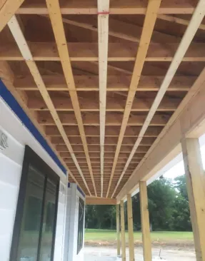

To prep the porch ceiling framing for the PVC T&G boards, workers installed strapping 10 inches on-center (left) and used construction adhesive to glue each blind-nailed board to the strapping (above).

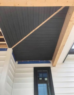

At the diagonals where the porch turned a corner, backing was needed for the T-shaped molding that would be used to cover the intersection.

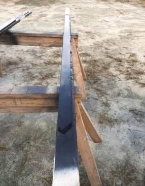

T-mold trim isn't yet available with a Kitami finish, so the author needed to prep and paint standard white PVC T-molding.

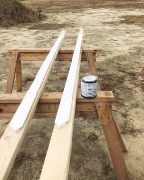

He used AquaSurTech D200 paint, which is formulated specifically for use with PVC, even in dark colors.

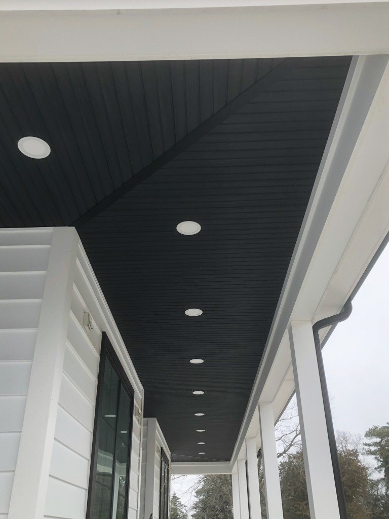

My Versatex friend supplied a sample, which my client agreed was just what the project called for, and I ordered enough boards with the Kitami finish to complete his 8-foot-by-80-foot ceiling. Following the company’s installation guidance, we strapped the ceiling joists 10 inches on-center to make sure that the boards would remain flat and used construction adhesive to ensure that they wouldn’t sag or start to come down. My two-person crew wrapped up the job in just one day, with ordinary carpenter’s tools.
The painted T-molding is a close color-match to the rest of the Kitami ceiling boards.
Kitami is currently available for T&G beadboard or 3/4-inch-thick WP4 stock, both with 4-inch crown and bed moldings to match. But it’s not yet available as a T-strip, which we needed to finish the angles. For that, we acquired a quart of matching AquaSurTech D200 paint (aquasurtech-oem.com) and PVC cleaner, on the recommendation of the Versatex tech department, and used them to color-match standard white PVC molding. ❖
