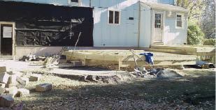

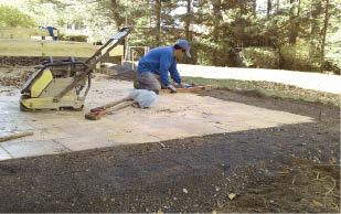

A selling point of hardscaping is that it costs a quarter to a third of what premium deck construction does. Rates for paver installations vary regionally, but most subcontractors I deal with install basic 6×9 non-tumbled pavers for $7 to $10 per square foot (Figure 1). By adding a patio to the project, I can provide my clients with a significant amount of additional entertaining area for a fraction of the cost of the deck. Hardscape features that are appropriately tied into the deck design also give the backyard a natural flow, from the height of the doors all the way down to the level of the grass. And it’s nice to be able to spread a crowd out on multiple levels.
Figure 1. Patios made from concrete pavers can add space to a backyard project at a fraction of the cost of a deck.

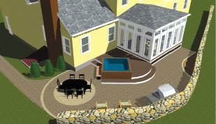

While a sketch may be adequate for basic features like walkways or patios, the best way to present your design is with 3D renderings (Figure 2). I use Realtime Landscaping Architect (Idea Spectrum; www.ideaspectrum.com), which costs $350. Run on a laptop, it’s a great in-home sales tool, although it’s not a comprehensive deck-design software.
Figure 2. Using 3D design software provides customers with an image of the finished project, greatly helping the sale.

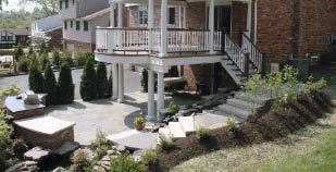

On bi-level homes, it’s common to find a mix of door-sill heights, anywhere from 2 inches to more than 8 feet above grade on the same structure (Figure 4). That is an ideal situation for blending a deck with hardscaping; a raised deck can use level changes to flow down to a larger patio at grade. Or if the deck is to be built off a second story, including a deck drainage system and putting a patio under the deck gives the homeowner a dry space for entertaining (Figure 5).
Figure 4. Homes with back doors at several elevations lend themselves to hybrid deck and patio designs.
Photos by Bobby Parks
Figure 5. Building a patio below an upper deck that incorporates a drainage system gives the customer outdoor entertainment options in inclement weather.

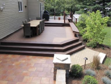

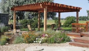

Last, working landscaping and plantings in around the hardscaping and the deck softens the edges and blends the design features together (Figure 6). Because I’m not formally trained to specify the right plants for a given yard’s unique planting characteristics, I show the same 10 plants in every 3D design to make the rendering look pretty for the initial sale. I’ll assign an agreeable planting budget for the project and let my subcontractor spec the actual plantings when the time comes. My design software also lets me include low-voltage landscape lighting, and I add that to the design as well.
Figure 6. Plantings ease hard edges and blend decks and hardscaping into the yard. Photo by: Robert Viviano

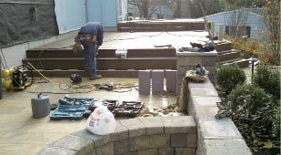

Working with known contractors is a big plus. If the deck has staircases that are going to land on a patio or walkway, the hardscaping needs to be completed while the deck is being built (Figure 7). If, for example, the client brings in his own contractors to do the work, you can bet they won’t show up when you need them, which will delay your part of the project.
Figure 7. Some parts of the job, such as building stairs, require close coordination between the deck builder and the hardscape contractor.
