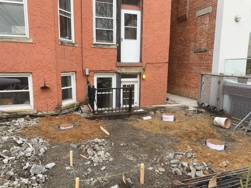

Our first order of business was to deconstruct the backyard, breaking up the concrete pads that made up the patio so that the debris could be hauled away. Not only were the pads in poor condition, they had settled every which way over the years, destroying the original pitch toward a central drain that had been installed in the backyard. As a result, rainwater pooled in the backyard instead of draining properly.
Workers began the project by dismantling the existing steel deck and breaking up the large concrete patio pads.

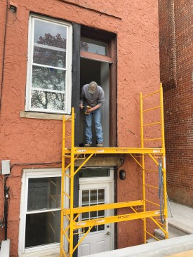

The project also included the replacement of the door leading out onto the deck.

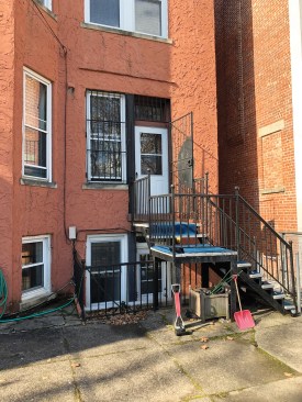

Next, we removed the original steel steps, landing platform, and small steel deck that were used to access the back door. With the back door access and patio removed, we turned our attention to locating the six footings required for the 11-foot-by-15-foot deck.
To support the frame, the architect specified two footings 5 feet 7 inches off the house and a second set of footings 12 feet 10 inches off the house. The footings in both sets were placed 10 feet apart. Each set eventually received an 8-inch steel C-channel beam that ran parallel to the house (north to south) and carried 4-inch C-channel joists running perpendicular (east to west) to the house. In addition, we marked out a pair of footings to carry the east-facing side of the stair platform, then dug footing holes by hand wide enough to receive 14-inch-diameter concrete form tubes, and deep enough—3 feet 6 inches—to get below New Jersey’s frostline.

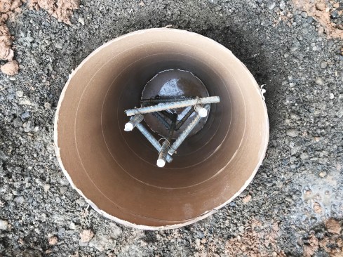

Prior to pouring the footings, we cut and wired together triangular-shaped rebar cages to insert into the cardboard forms. After the building inspector checked the cages and approved our footing design, we pulled out a laser level to check elevations so that we would be able to cut the forms to the proper height before mixing and pouring concrete.
Six new poured-concrete deck footings were required for the new deck.
The 14-inch-diameter by 42-inch-deep deck footings were reinforced with triangular rebar cages.

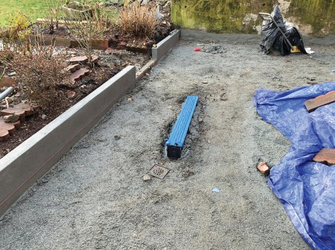

Drainage. The backyard lawn was higher than the patio, which caused water to flow off the lawn and toward the house. This problem was compounded by a walkway through the middle of the V-shaped backyard, which acted as a culvert depositing water onto the patio. To make matters worse, a set of tennis courts belonging to nearby Stevens Institute of Technology lay to the south of the property at a higher elevation, and when the tennis court drains became clogged with leaves and debris, even more water flowed down into the yard and inundated the property.
After rebuilding the planting-bed walls that separate the patio area from the back yard, workers connected a new linear drain to an existing drain line to improve drainage.
To make sure water would drain off the patio, workers screeded the QP (quarry process) setting bed for the new concrete pavers off of rigid pipe pitched toward the linear drain.

Our plan to address the problem was simple, because there wasn’t much we could do without major grading changes, which weren’t in the budget. We rebuilt the planting-bed walls so water could enter the patio only from the lawn walkway and installed a linear drain connected to an existing drainpipe that extends the stormwater collection point toward the lawn walkway as much as possible. (We also made it a point to ask the Stevens staff to maintain clear drains.) Finally, and most importantly, we made sure the new patio was pitched properly to the drain, unlike the old patio, which had only a slight pitch and then settled over the years.

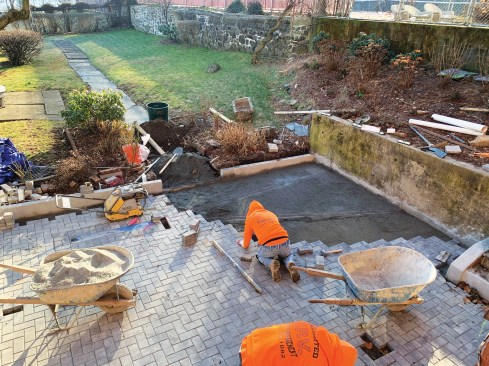

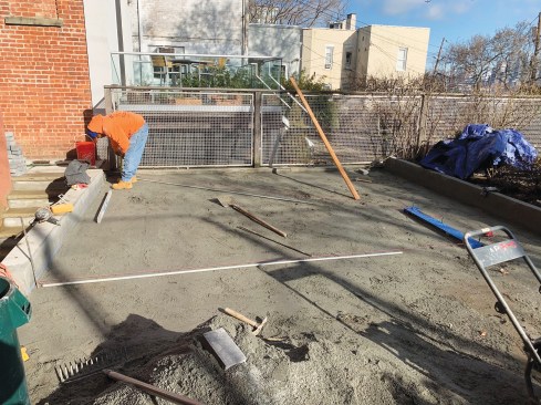

Hardscaping. After masons completed the planting-bed border wall, they wheelbarrowed in a mix of crushed stone and stone dust called QP (for quarry process) to create a solid base for the pavers. Working from our benchmark elevation at the alley walkway, we helped them set the drain so that its top would be 2 inches lower than the walkway and the perimeter pavers abutting the house.
Because the drain was offset toward the lawn walkway, there was a long, shallow pitch from the house to the drain 15 feet away. To help achieve the necessary pitch from perimeter pavers to the drain, the masons set up string lines to represent the top surface of the finished patio, then bedded 3/4-inch-diameter rigid pipe in the QP 2 3/8 inches below their string lines. Then they screeded off these pipes to create a smoothly pitched setting bed for the 2 3/8-by-4-by-8-inch Holland concrete pavers.

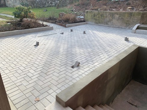

The masons laid the pavers in a herringbone pattern. Whenever the layout intersected with a footing location, they left a paver up on edge so that we could easily locate each footing after the patio was completed.

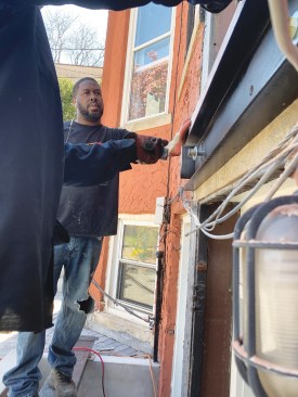

Ledger installation. We weren’t comfortable with the idea of using wedge bolts drilled into the century-old stone door lintel to install the short section of ledger that would connect the deck frame to the house. Instead, we opened up the interior wall to gain access and drilled a pair of 5/8-inch-diameter holes through the stone lintel spanning the basement door opening directly underneath the entry door for 1/2-inch-diameter through-bolts. Then we bolted the ledger to the house, inserting the long bolts through both the sill itself and a 1⁄4-inch-thick steel backing plate that we installed behind the stone sill.
The steel deck frame is basically free-standing, but is connected to the house via a short steel ledger through-bolted to the masonry wall below the entry door.

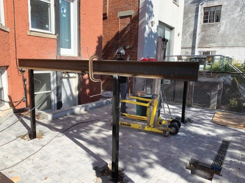

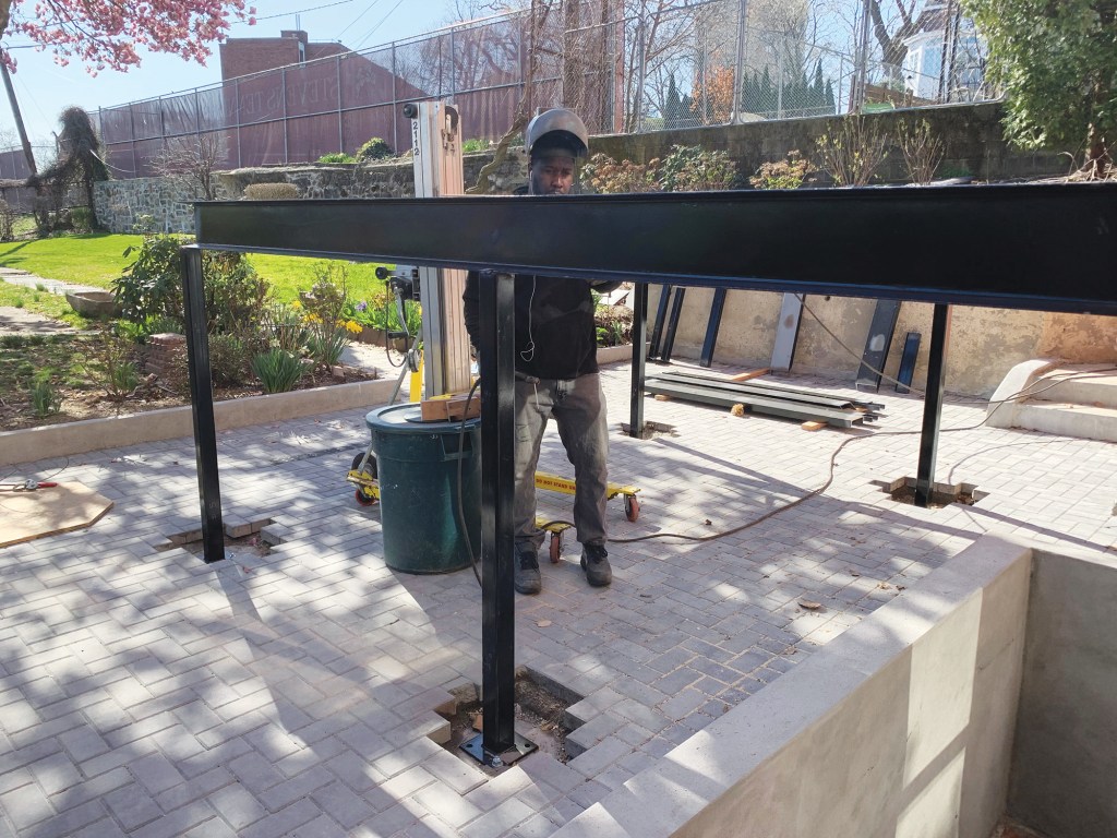

Next, we placed the six deck posts onto the footings, holding them upright with a single, loosely-threaded nut on one of the anchor bolts. We waited to install the nuts on the remaining three anchors for each column until the frame was welded together. This allowed Joe to make slight adjustments to the steel framing so that everything was plumb and level prior to welding the assembly together.

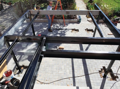

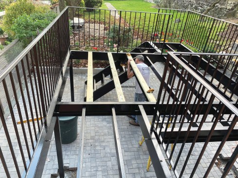

First, Joe welded the two rim joists running perpendicular to the house to their support columns. He also welded the end of one of the rim joists cantilevering past its support column to the house ledger, adding integrity to the developing structure.
The installation then became a puzzle that Joe welded together in a meticulous way, starting with the two main rim joists that were parallel to the house and attached to the posts and perpendicular rim joists. This was followed by the perpendicular rim joist that attached to the opposite side of the lintel, followed by the last parallel rim joist closest to the house.
During the welding process, the posts self-located into their final positions on top of the footings, and we went ahead and installed the remaining wedge bolts to secure each in place.
The fabrication crew used a portable lift to maneuver the heavy steel beams for the deck frame into place.
After the crew welded the 8-inch rim joists together and to the columns, they added 4-inch steel joists to the deck frame.
Once the posts were secured and all the 8-inch C-channels were installed, Joe welded the 4-inch joists into place, followed by the steel rail system that he had also fabricated back in his shop. Before leaving, he ground smooth the welded joints, brushed on an oil-based primer, and then painted them with two coats of oil-based finish to match the finish that had been applied back in his shop. Then he measured for the stairs, which would also be fabricated in his shop.

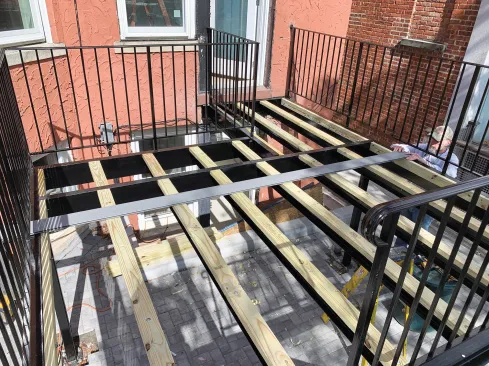

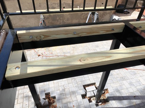

Wood framing. To fasten the decking to the deck frame, we needed to first install pressure treated 2×4 sleepers on top of the steel joists. To do this, we drilled 3/8-inch-diameter holes in the C-channel flanges every 24 inches on-center for 5/16-inch-diameter hex-head bolts, which we used to bolt the sleepers to the flanges. To ensure that the bolt heads wouldn’t interfere with the hidden fasteners or deck boards, Danny countersunk holes to accommodate the hex heads.
We also needed to install 2×4 cleats along the inside faces of the rim joists to receive the decking fasteners. Instead of drilling holes through the webs of the rim joists, we asked Joe to weld hex-head bolts to their inside faces every 2 feet on-center. Then Danny transferred those locations to the cleats and drilled holes for the bolts.
After adding the railing sections and stairs, the fabrication crew reprimed and repainted the frame to prepare for decking installation.
To provide nailing for the decking fasteners, PT 2×4 sleepers were bolted to the tops of the joists and PT 2×4 cleats were bolted to the rim joists.
Then we lifted each cleat into place and secured it with washers and nuts, using a belt sander as needed to grind down the cleats wherever they stood proud of the rim joist. With all the sleepers and cleats in place, we moved on to the decking.
To ensure a flat plane for the new composite decking, project manager Danny DoCoutu countersunk the holes for the bolts used to fasten the sleepers to the steel framing.

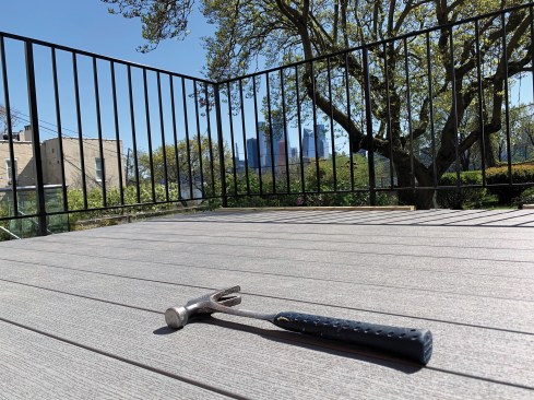

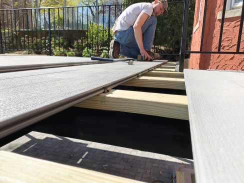

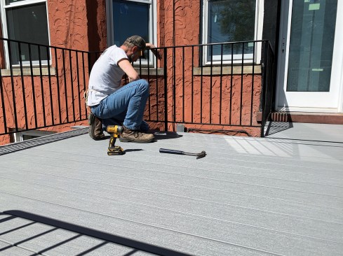

Decking. The hardest part about installing the decking was finding the right material, because the homeowner wanted to match the color of an existing third-floor deck. Because the decks were far enough apart, the color only had to be close, rather than a perfect match. Still, it was an effort, because we needed decking with grooved edges for a hidden fastening system, and we wanted 12-foot lengths to eliminate seams on the 10-foot-by-12‑foot deck. One supplier had the color but only in solid edges, while another had the color and grooved edges but only in 16‑foot and 20-foot lengths. Eventually, we found a supplier that had just what we needed: TimberTech Edge Premier maritime gray grooved boards in 12-foot lengths. We also ordered enough square-edged boards for the stair treads.
We installed the decking using TimberTech Concealoc hidden fasteners.
TimberTech Concealoc hidden fasteners were used to connect the grooved TimberTech deck boards to the pressure treated sleepers.
The decking had to be notched to fit around the rail posts, which had been welded to the deck frame.

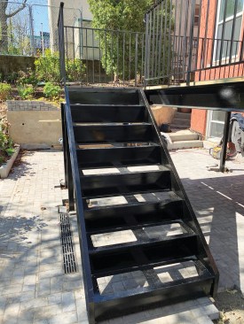

A week later, Joe returned with a set of stairs that he had fabricated at his shop, and that were ready to be welded to the deck platform. He also brought with him two railings—one for each stair stringer—that he welded into place once the stairs were secured.

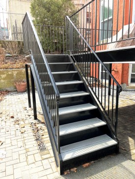

At the top landing, the top edge of the framing measured 66 inches above the bottom landing where the stairs bear on the patio pavers. Joe had joined the two 10×8.4 C-channel stringers together with seven 36-inch-long tread-riser assemblies and a single riser at the top fabricated from 9-gauge steel plate. Six of the assemblies and the single riser at the top measured 8 1/4 inches high, while Joe fabricated the tread-riser assembly at the base to have a 7 1/4-inch-high riser. With the treads attached, each riser measures a consistent 8 1/4 inches high.
The staircase was fabricated off site, then brought on site and welded to the deck frame.
Next, the prefabricated railings were welded to the stringers and the upper railing. The TimberTech composite treads were fastened to the steel subtreads with screws driven up into the treads from below.
The treads are made up of two pieces of 1×6 square-edge decking for a total width of 11 inches. The steel tread-riser assemblies measure 10 5/8 inches deep, allowing the treads to have a 5/8-inch overhang with 1/8-inch gaps between the deck boards and at the risers.
The New York skyline is clearly visible from the new steel-framed deck, which has a much larger footprint than the original deck.
To fasten the decking to the steel stairs, Joe had drilled holes in the subtreads, two at each end and two in the middle for a total of six holes per board, or 12 holes per tread. The holes allowed Danny to fasten the boards to the frame from underneath, keeping the board faces unblemished. The first set of boards, low to the paver patio, was a challenge, but a right-angle offset driver—and a little bit of cursing—did the trick.
