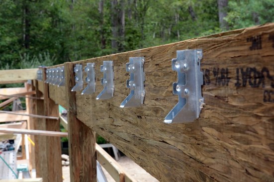

Unlike other types of structural composite lumber, parallel strand lumber (PSL) can be preservative-treated to meet AWPA UC3B and UC4A standards, making it an option for deck framing.
Weyerhaeuser
Like PT dimension lumber, EWP members that are treated for UC3B should not be used in ground contact or in locations where they are critical to the structure and difficult to replace. Products treated for UC4A are generally suitable for use in deck substructures and some ground contact applications. Consider specifying use category UC4B to provide additional protection for columns. Examples of engineered wood products suitable for outdoor use that follow AWPA provisions are Weyerhaeuser’s Parallam Plus PSL beams, which are treated for use-category UC4A (Ground Contact-Low potential for decay,) and Parallam Plus PSL columns, which are treated for use-category UC4B (Ground Contact/Salt water splash-high potential for decay.
