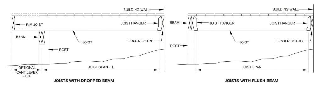

The IRC permits cantilevers up to one-fourth the span of the joist, with the cantilever distance (or overhang) measured from the center of the supporting beam to the outermost framing material, typically the rim joist. The long backspan effectively limits uplift at the ledger.

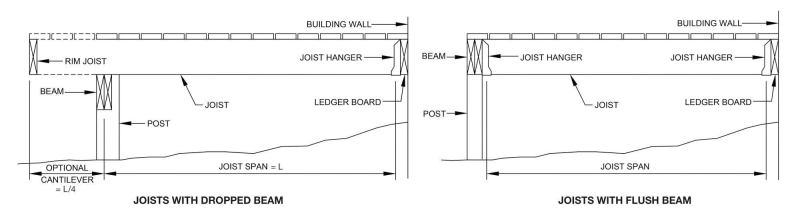

According to the new span tables and IRC provisions, cantilevers can extend up to one-fourth the backspan of the joist. This means that joists, such as southern pine 2x10s at 16 inches on-center, spanning 12 feet are allowed to cantilever up to an additional 3 feet (see illustration, below).
There are two sections in the new span table: one for joists with cantilevers, and one for joists without cantilevers. Cantilevering a joist produces greater stresses in the primary joist span (backspan), so the maximum span is often reduced. For cantilevers greater than the depth of the joist material (9 1/4 inches for a 2×10), you must use the span criteria for “joists with cantilevers.”
These joist span tables and cantilever allowances might be old news to those familiar with DCA 6 (awc.org), but there are a few differences. For example, under the portion of the joist span table for joists without cantilevers (and thus a longer allowable span), joists are still allowed to cantilever up to the depth of the joist material. This will allow for minor adjustments to beam placement, without affecting the maximum span.
Another difference is that the current IRC requires full-depth blocking over the beam when joists are cantilevered beyond, while DCA 6 does not address this. The new IRC provisions strike a balance, requiring blocking over the beam when joists cantilever, but allowing the blocking to be cut to 60% of the joist depth to accommodate deck-drainage systems that install within the joist bay.
