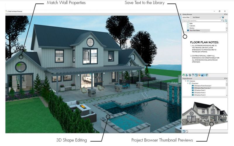

New features in Chief Architect X13 include a dynamic task-linked help menu that can be toggled on and off, thumbnail previews for saved elevations and schedules, 3D shape editing, and a text library that allows general descriptions to be used in future projects. Attributes from one wall can now be applied to other walls as well.
Screen Capture Courtesy Chief Architect New features in Chief Architect X13 include a dynamic task-linked help menu that can be toggled on and off, thumbnail previews for saved elevations and schedules, 3D shape editing, and a text library that allows general descriptions to be used in future projects. Attributes from one wall can now be applied to other walls as well.

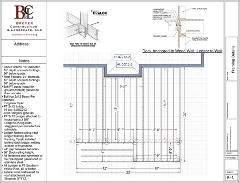

Like previous versions, Chief Architect X13 is well-suited for creating construction drawings with framing and connection details. Shown above is the structural design for one of the author’s projects that is currently in build.

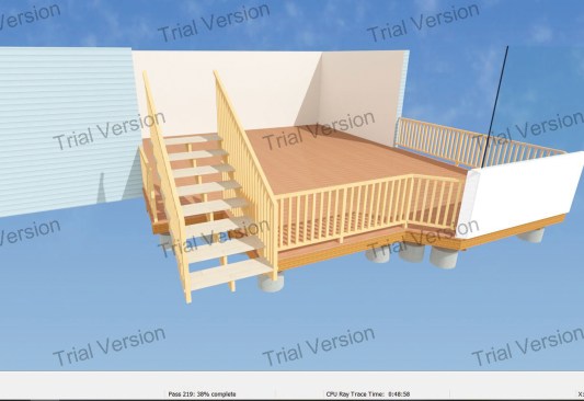

To better appreciate the basics of what the software can do and to learn a little bit about what has been improved upon, I started by watching the introduction video for a prior version (X12), and then the video for this new release. Then, as is my habit, I simply jumped in and attempted to design a rather basic deck, with a set of steps, railings, and a glass wall or rail along the front section. I’ve included a screenshot of my attempts so you can have a laugh at my expense (see image, left). It took me perhaps 30 minutes of working with the program, trying to figure out the tools and menus, to get to this point … which is about 10 times longer than it would have taken me to deliver a completed 3D design for a deck this size in Visionscape. That may be an unfair comparison, but my point is that this is not a fast, “jump right in” program; it’s a “spend weeks learning this before ever using it for client work” kind of program.
While Chief Architect X13 boasts a new “engine” that speeds up 3D renderings, the author found that the learning curve is steeper than with simpler CAD programs for decks. Shown here is his initial attempt at a deck design after taking a brief X13 tutorial.
If I were planning on using this software full-time, I’d invest in watching the training on setting elevations, making sure stairways properly connect, and applying finishes to walls and deck floors before ever creating designs for clients. Chief Architect X13 has a ton of tools and power, but it is a bulky program, and it forces you to design in a 2D environment before rendering in 3D—whereas my background is mostly in designing in a dynamic 3D environment before generating static 2D drawings as needed.
