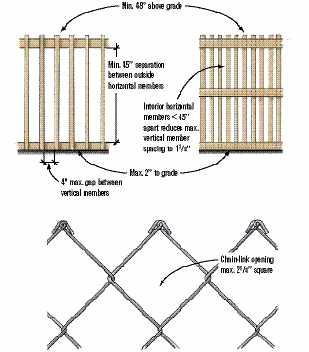

While that’s the simple approach to hot-tub-barrier compliance, a standard pool barrier can also be used. There are 10 specific requirements for construction of pool barriers, and after reviewing them you will see why I strongly suggest the use of the approved cover. Detailing the requirements is very involved and outside the scope of this answer; the following brief summary should be enough to convince you of this:
• The minimum barrier height is 48 inches above grade, as measured on the side of the barrier that faces away from the pool (outside the pool area).
• Maximum clearance under the barrier to grade is 2 inches.
• The barrier cannot be climbable.
• Solid barriers, such as masonry or stone, cannot have “indentations or protrusions other than for normal construction.”
• Maximum mesh size is 2 1/4 inches square for chain link, unless filled with slats reducing the opening to a maximum of 13/4 inches.
• For diagonal members (lattice), the maximum opening is 1 3/4 inches.
• Horizontal members not on the pool side must be at least 45 inches apart.
• When horizontal members are on the pool side and less than 45 inches apart, the opening between or within vertical members must be less than 13/4 inches.
• Gates must comply with barrier requirements and have a locking device.
• Gates must swing away from the pool and be self-closing and self-latching.
• If the gate latch release is less than 54 inches from the bottom of the gate it must be located on the pool side at least 3 inches from the top of the gate, and the gate and barrier can’t have an opening greater than 1/2 inch within 18 inches of the release mechanism.
• If the dwelling acts as part of the barrier, the doors to that area must be provided with an alarm system (full of specific details), or provided with self-closing and self-latching doors that are approved by the building department and provide the same level of protection as the alarm.
