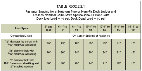

IRC Section R502.2.2 requires positive anchoring of non-freestanding decks to the primary structure and prohibits toenailing or using nails to make this connection. In the 2007 IRC Supplement, Section R502.2.2.1 was just adopted to clarify this provision (Figure 3). It specifies the use of lag screws, or bolts and washers when attaching the deck ledger to the primary structure.
Figure 3. The International Code Council adopted Table R502.2.2.1 in May 2007 (see “New Ledger Attachment Requirements Adopted,” PDB, July/August 2007). The fastener schedule is based on research done at Virginia Tech and Washington State University.
