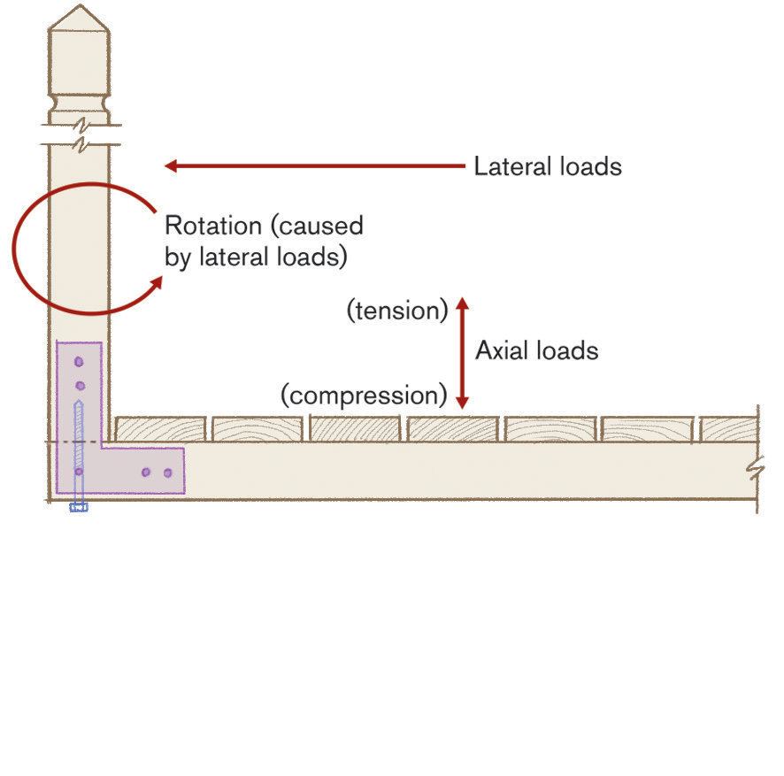

Q: Because of limited clearance, I’m building a rooftop deck with 4×4 or doubled 2×4 joists. What is the best way to fasten 4×4 posts to the deck framing in order to meet California codes, which have typical IRC post-deflection limits and call for a 42-inch railing height above the deck surface? The entire rooftop deck is floated on foam.
A: Paul Bennett, P.E., a managing engineer with Exponent Failure Analysis Associates, in Boulder, Colo., responds: In general, I would advise against trying to anchor a 4×4 deck post to a 2×4 or 4×4 joist. Testing has shown that anchoring a post to a joist smaller than 2×8 is likely to result in premature failure due to the joist cracking. But the question—and your proposed solutions (see illustrations A, B, and C)—is worth addressing here because of the issues it raises. The first is the misuse of structural hardware.
In the first option (A), for example, the L-straps being used to create a connection to resist rotation will instead result in what we geeks refer to as “cross-grain bending” on the post. In plain English, this means that when a significant lateral load is placed on the top of the post, the post base may split about the bolt holes. While the hardware shown can resist some post rotation, it is really intended to resist axial load; that is, the load created by pulling straight up on the post.
