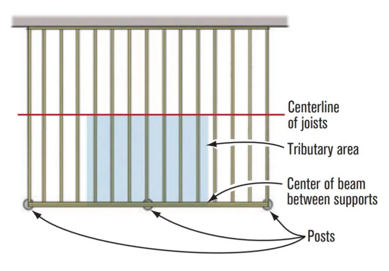

Figure 1. Determine the tributary area on a footing by measuring half the beam and joist spans on each side of its post. Include all of any cantilever. Multiplying these dimensions provides the square footage of the tributary area, and multiplying the square footage by the design load (typically 50 psf) yields the tributary load.

It’s fairly simple to determine the bearing area at the bottom of a foundation required to transfer loads to the earth. First, the tributary load on each post must be calculated. This equals the area of the deck that’s supported by the post multiplied by the combined design live and dead load (40 psf and 10 psf, in most cases). The area supported by the post is found by dividing in half the joist and beam spans on all sides of the post (Figure 1). For large decks with multiple beam spans, the loading for each post may be significantly different; a center post in a long beam will usually carry twice the load of a corner post. For simplicity, a builder will often make all the piers identical, sized for the largest load.

Once the load supported by each pier is determined, the next item to consider is the soil. The IRC provides a table for the compressive strength of various soil types, but it’s not much help unless you know the difference between silty sand and sandy silt (2,000 or 1,500 psf respectively). Expect 1,500 psf to be the default value in most jurisdictions (though I know that many allow more like 3,000 psf for decks). Dividing 1,500 pounds by a design load of 50 psf shows that a 1-square-foot bearing area (size of pier) can easily support 30 square feet of deck. Since most piers aren’t square, but rather round, remember you’ll need to find the area of a circle (pi times the radius squared, or for easier job-site math, approximately three-fourths of the area of a square whose sides are the same length as the circle’s diameter).
