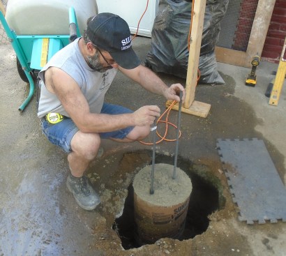

A pair of 1/2-inch rebar rods embedded in the fresh concrete will tie the pier to the expanded footing below the cardboard form, creating a more stable foundation.

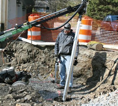

Helical piers can be installed in any weather, have a higher load capacity than concrete, and require less cleanup. Though more expensive than concrete piers, they are helpful in poor soil conditions, or where frost heave is a concern.
Greg DiBernardo

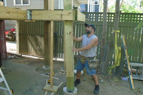

The depth and size of concrete footings depend on location and soil type, as well as on the deck loads the footings need to support. In northern parts of the country where frost heave is a concern, for example, footings must be dug 48 inches or deeper to meet code. But frost is a relentless adversary, so Boston-area builder Emanuel Silva likes to beef up his footings to make them more robust.
Like many builders, Silva uses cardboard forming tubes, but before placing a form, he enlarges the bottom of the hole to create a footing that will help the concrete resist frost heave. Once the form is in place and the concrete poured, he plants a pair of 4-foot lengths of 1/2‑inch rebar into the fresh concrete so that the footing below and the pier above will have a stronger connection.

According to Jacobson, installation time with helical piers is a fraction of what it takes to dig and pour concrete. Even though the cost per pier is higher (about $350 each), the schedule is streamlined because he doesn’t have to wait for an inspection or for concrete to cure. Also, less soil is displaced, so there’s no yard clean-up cost. And there’s no guessing with helical piers: Their bearing capacity can be measured, and they’re not affected by frost heave.

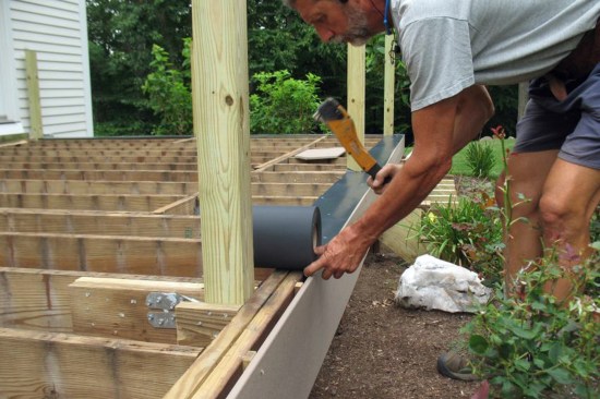

Many builders use self-adhesive membranes in various widths to protect deck framing from moisture. Here, narrow tape covers the gap between the fascia and rim, while wider pieces of membrane protect corners and doubled framing.

Katwijk is a fan of G-Tape, an acrylic adhesive flashing tape that will stick to almost anything, even wet surfaces (gtapesusa.com). But there other options as well, including Trex Protect, Henry Bluetape, and 3M flashing tape. Austin, Texas, builder Matt Risinger prefers to use Grace’s Vycor tape to cover the tops of his deck joists.

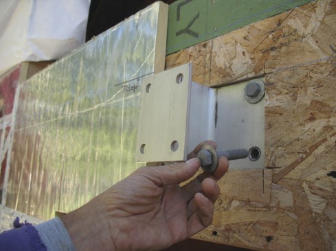

Guertin sometimes uses a product that promotes drainage between a deck ledger and the house: Deck2Wall Spacers (deck2wallspacer.com). These are code-approved discs made of glass-filled polypropylene that are fastened to the back of a ledger to create a structurally sound attachment that drains water away from the ledger and house flashing.
Made of solid aluminum, Maine Deck Brackets also create a structurally sound method of keeping water away from the house and ledger.
Mike Guertin

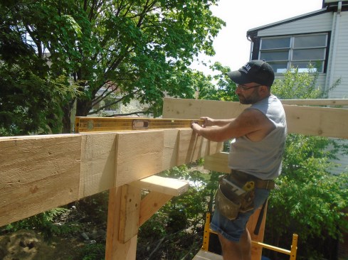

To keep water from collecting between double or triple rim and support beams, Emanuel Silva likes to separate the 2-by layers using PT plywood or PVC spacers. He assembles the beams on temporary supports and places the spacers at regular intervals so that water will drain from the assembly. He staggers the 2-by joints by at least 6 feet.

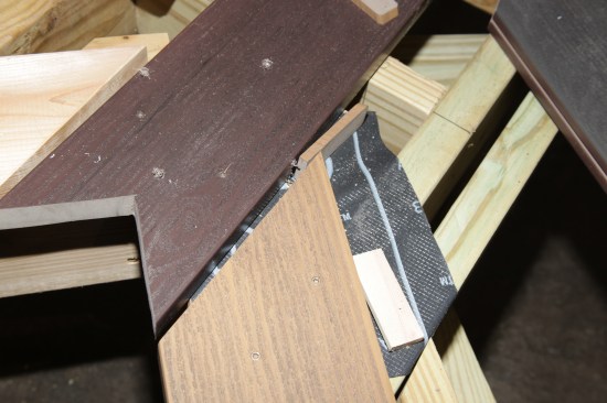

Gapping miters at intersecting deck boards will allow water to quickly drain away from vulnerable end cuts.
Charles Bickford

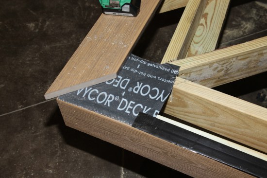

PT spacers between the fascia and framing and a membrane cap over the gap will minimize potential water damage to the rim joists.
Mike Guertin
Deck boards that are installed with too small of a gap between them can trap debris and prevent water from easily draining off the deck. To ensure good drainage and create a consistent gap between adjacent deck boards, Kim Katwijk uses a 3/8-inch-thick spacer as a guide when installing square-edged decking.
Another potential moisture trap is between the rim joist and the fascia trim. To provide drainage, Mike Guertin nails 3/8-inch-thick PT rippings to the rim joist at 16-inch intervals prior to fascia installation.

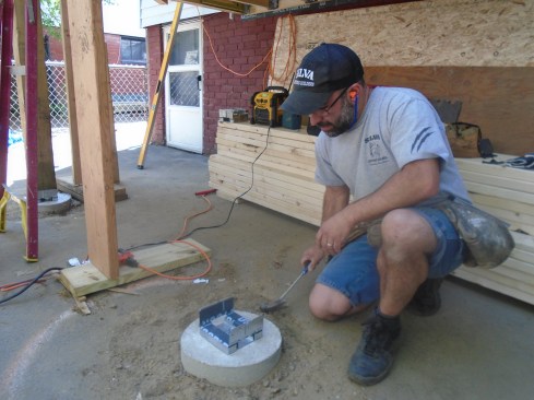

Covering the top surfaces of a galvanized post base with strips of self-adhesive membrane before setting the post in place helps to isolate the metal connector from the corrosive effects of pressure-treated lumber.

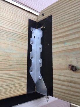

To limit corrosion, Emanuel Silva uses self-adhesive membrane as a barrier wherever metal connectors and PT framing come in contact. Another builder who uses this approach is Brian Jacobson, who wraps the ends of joists with G-Tape where they’ll come in contact with galvanized hangers.
Though newer PT formulations aren’t as corrosive as ACQ-treated lumber, many builders still wrap joist ends with self-adhesive flashing tape prior to hardware installation.

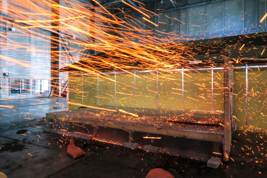

In testing conducted by the Institute for Business and Home Safety to simulate a wildfire environment, sample decks were exposed to windblown embers (which can start fires hundreds of yards from an active fire). Results showed that higher-density and solid decking were more fire resistant than low-density and hollow decking. Another key fire-resistant detail: Metal flashing that covers the first 6 inches of siding will help prevent windblown embers from building up at the intersection of the house and deck.

Quarles says that because decks are usually open underneath and have a walking surface of spaced boards, they are susceptible to windblown embers from nearby fires. These embers can travel hundreds of yards from an active fire and then ignite dry vegetation, like pine needles, that collects between the deck boards and joists and beneath the deck. Given the right circumstances, they can start a fire on their own, even on a well-maintained structure. So, the first lessons are to keep combustible vegetation away from the house, keep decks swept clean of debris in fire season, and don’t discount the dangers of windblown embers.
Even though California’s building code specifies the use of certain decking products for fire safety (2-inch-thick cedar or redwood, for instance), Quarles notes that tropical hardwoods, higher-density wood-plastic composites, and lumber treated with fire retardant were less vulnerable to ignition than the lower-density woods (such as redwood) when exposed to wind-blown embers during testing. Solid decking generally performs better than hollow or channeled deck boards.
