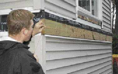

I install and flash the ledger before laying out the footings, ensuring the footings will be accurate to the plans created at my desk. I usually run a string line across the installed ledger to see if the wall is bowed out or in. If the ledger has more than a 1/4-inch bow in it, I’ll adjust the joist lengths accordingly (Figure 3). Once the ledger is done, I set one crew member up at the cut station and two on footings and layout.
Figure 3. Houses aren't always straight, so the author checks the ledger with a string. Variations greater than 1/4 inch mean that the joists will have to be custom cut.

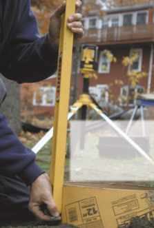

Once the forms are in place, I use my laser transit to set the level I’ll pour the concrete to (Figure 6).
Figure 6. Using a laser level with an audible sensor, one man marks the footing forms with a nail through the cardboard, so all the concrete can be poured to the same height.
Placing all the concrete to the same level makes life much easier later because all the posts can be cut to the same size. If the grade around the deck varies too much, however, some of the footings will stick out of the ground like a sore thumb. In that case, I keep the footings about the same distance out of the ground and cut the posts to length individually. I set anchor bolts in the wet concrete, aligning them on a string line from the batter boards (Figure 7).

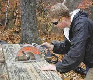

I cut posts using a worm-drive saw with a 10 1/4-inch Big Foot Adapter (Big Foot Tools, 702/565-9954, www.bigfoottools.com). With one line and one cut the post is ready for installation (Figure 8).
Figure 8. The right tool can be a big timesaver: The Big Foot Saw Adapter allows for a 101/4-inch blade in a standard Skilsaw and cuts 4-inch stock in one pass.

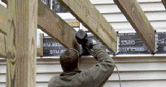

The outer posts are attached to the pre-cut and laid-out beam, and the assembly is raised into place like an exterior wall. Once the beam is plumb, toenailing the outside joists secures and steadies it. Next, I infill the remaining posts, and the beam is ready to support the rest of the joists.

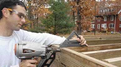

Cantilevering joists over a beam provides a level platform on one side of the deck to rest joists on, and means that one person alone can install a joist. To double the speed of joist installation, I use two guys, one at each end of the deck. At this stage, they just drive a couple of toenails into the ledger, and none in the outer beam (Figure 9).
A crew member with a metal connector nailer will follow behind and install the joist hangers.
Figure 9. Resting the joists on the girder, one carpenter toenails them in place (top). A second crew member follows behind, using a metal-connector nailer to fasten the joist hangers (bottom).

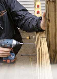

With the floor framing finished, it’s time to install the guardrail posts, bench posts, and detail blocking for decking patterns. While one crew member is still installing hangers and hurricane clips, the other two split up the remaining blocking and post installation. All post locations have already been laid out by the cut guy, so all I have to do is install the posts.
On other crews, I often see two people installing posts — one holds a post while the other lags it into place. This should be a one-person job. I mark the location of the top of the joist on the bottom of the pre-cut posts, and set a 12d nail one-third of its length into the post. The nail supports the post on the joist while I drive a LedgerLok screw (FastenMaster, 800/518-3569, www.fastenmaster.com) to hold it temporarily in place (Figure 11). Many crews notch posts to set their heights; however, notching a 4×4 post doesn’t leave enough meat to resist the code-required 200-lb. load for guardrails — and it’s time consuming.
Figure 11. A nail placed in the side of the newel supports it while it's initially secured with LedgerLok screws. Later, the newel is shimmed plumb and secured with a DeckLok Bracket or a Simpson HD5.
After all the posts are set, I go back to plumb, bolt, and install a hold-down bracket on each one. When installing three or more posts on the same joist, I set and fasten the outer posts plumb and run a string line on the outside of the posts from one to the other. This saves time when installing the inner posts on the same rim. Instead of pulling out the level and checking each post, I set them to the string and fasten them properly.
