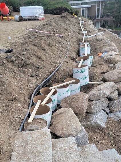

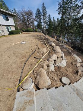

Creating 44 individual footings that are perfectly level with each other on a sloping site was a challenge. While the landscapers were building the retaining wall, I worked with them to place compacted gravel in the line of the footings, then they backfilled to finish grade (see photo below, at left). We dug each footing by hand to set the 44 12-inch-diameter cardboard footing forms 24 inches deep, relying heavily on a laser level as we took a full day setting, bracing, leveling, and double-checking the forms before pouring concrete (see photo below, at right).
We mixed the concrete by hand and carefully shoveled each scoop of concrete into the forms so as not to disturb them. We used a concrete vibrator to eliminate air pockets, then rechecked with the laser before finishing the pour. Mixing concrete by hand sometimes creates slightly different slumps from batch to batch, so we let the footings set for two weeks in case there was uneven curing.

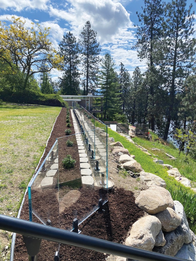

We used 1/2-inch-thick wood strips cut to the length of the panels to align the spigots, dry-setting the spigots on the footings to get our lines. Then we drilled holes for the anchor bolts and set the spigots, knowing they would probably need adjustment after we set all the glass loosely to check the fit.
I would like to say all the footings were perfectly level, but that was not the case. But they were within 1/8 inch of each other and needed only a slight bit of shimming inside the spigot. We also started by setting the glass panels over the lowest footings, knowing that we could grind the concrete down on the higher ones. Once the straight line was created, we also did minimal shimming of some of the spigots from front to back. The final process was getting each glass panel to flow level into the next, which required very fine shimming and minor adjustments for equal spacing.
