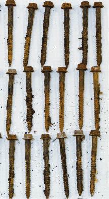

Figure 1. Many new wood treatment chemicals are more corrosive than the old CCA. Hardware that once could be depended on to last for decades now may degrade in only a few years.
The “retention level” of treatment chemicals is another factor to look out for — wood that’s treated for ground contact contains more preservative than wood that’s intended for aboveground use, and therefore is more likely to cause corrosion.
This chemical stew boils down to one thing: The pressure-treated wood you’re using wants to eat your hardware for lunch. A study done by Simpson Strong-Tie found that ACQ is twice as corrosive to metals as CCA, and some other studies have found it to be three times as corrosive.
