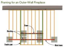

Carrying the Load
The framing and siding of a chimney and firebox — and especially the weight of stone facing and a hearth — create a concentrated dead load that requires extra beams and footings. If the project doesn’t include stone facing, it’s easy enough to adapt beam and header sizing from the IRC.
When there is stone facing, though, I ask the stone supplier to provide the weight per square foot, which I then use to size the beams and footings (see “Designing Pier Footings,” January/February 2007; free online at deckmagazine.com). If that’s beyond your expertise, spend a few hundred bucks on an engineer. The peace of mind alone is worth it.
The configuration of the joists and the beam below will depend on the fireplace orientation (more on this later). Wherever point loads are transferred through joists onto a beam, solid blocking is needed between the joists to prevent them from rolling under load.

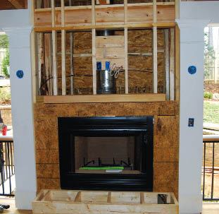

Framing a Chase
Typically, the chase’s depth is based on the fireplace manufacturer’s clearance specifications — as little as 2 feet to as much as 3 feet. I prefer to make the width of the chase 6 feet because that allows enough room for a significant stone facing and mantle, plus it makes for efficient use of sheathing and siding materials.
The floor framing for fireplaces is similar to the rest of a deck or porch. You can either continue the porch flooring into the chimney chase to create a floor, or just use plywood. As with decking, affix the sheathing to treated-wood framing with fasteners that are hot-dip galvanized or stainless steel.
If you’re familiar with standard wall framing, you can build a chimney chase. The walls are framed on the floor and raised, like they are in home construction. Don’t side right over the studs — sheathing the walls with 1/2-inch OSB or plywood is important for strength, and heavy stone facing will require the lateral support (be sure your mason ties real stone to the chase with an appropriate quantity of brick ties). The sheathing also provides sheer bracing needed to resist the force the wind exerts on the chimney chase, which offers quite a sail area.
The chase must have fireblocking at the level of the porch ceiling. This is usually accomplished by building the first section of wall to this level and capping it with a floor of 3/4-inch-thick plywood or OSB. The fireplace installer will cut out the floor around the flue and install a metal flange.
Once the chimney chase is framed, temporarily attach a piece of OSB or plywood and a tarp over its top to keep rain out until the cap and shroud are installed.
My three-man crew can usually frame a chase and its floor in one work day.

Outer-wall fireplaces create the most dramatic finish (Figure 4).
Figure 4. Particularly when paired with cathedral ceilings, end-wall fireplaces can make a dramatic, if expensive, statement.
They become the focal point of a porch and, with open gable porches, show a lot of stone work. Of course, that additional stone work costs more money, and the chimney has to extend past the roof peak, not just the side of the roof, so it will be taller. The customer should also consider whether the fireplace will block a desirable view from the inside of the house. But the cantilevered bump-out is simple to frame, as it’s a simple extension of the main floor framing.

Choosing a Firebox Unit
Fireboxes come in different sizes, which are designated by the size of the firebox opening. The one I install most often is 24 inches by 42 inches, because smaller units don’t look as good and aren’t worth what little savings they provide, and the next size up can cost significantly more. To make the fireplace seem larger and provide a better view of the fire, I raise the firebox up about 8 inches by building a platform with 2x8s and plywood on top of the floor framing for the firebox to rest on.
Although stainless steel units are the best, they’re also more expensive. Standard painted units can be used inside porches with good results — unlike outdoor fireplaces, porch fireplaces are not exposed to direct rain. An exception to this might be an area like the Northwest, where rain and humidity levels are constant or extreme, or on the coasts, where the salt air rusts everything.
I recommend a couple of upgrades: fireplace doors and blowers. Fireplace doors, if the weather’s windy, can be closed to prevent embers from blowing out onto the porch. And blowers are well worth the extra cost, as moving warm air into a porch during the fall or winter will make the space more inviting. Units with blowers can be purchased for an additional $250 to $350, plus the cost of wiring.
