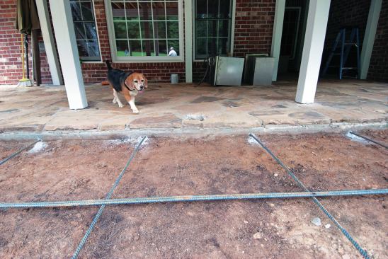

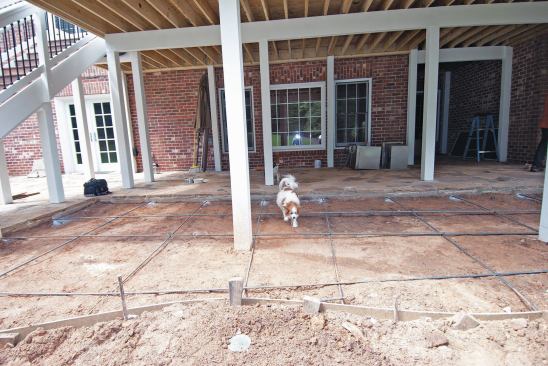

A concrete slab can be extended, but the new pour must be pegged to the old slab to prevent differential settling. When there’s any type of grade, we need to factor in the cost of turning down the outer edge into the grade at least a few inches to prevent erosion.
When overhead structures are involved, footings can be incorporated into the concrete pour or they can be dug and poured beforehand. We often build porches and watertight decks and load our columns prior to a patio pour. The key is to make sure the top of the footing is lower than the bottom edge of the patio so that it doesn’t interfere with the concrete thickness.

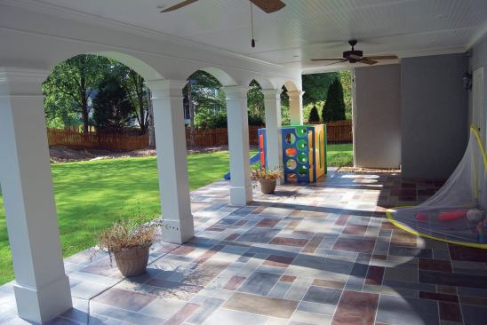

Concrete coatings. Concrete coatings can bring new life to an old concrete pad, as long as it’s structurally sound. We often use coatings to blend old patios and new extensions together, by providing them with a consistent finish. Coatings are also great for covering patches in concrete, such as when we need to cut through a slab to install column footings. In our market, coating prices start as low $4 per square foot.

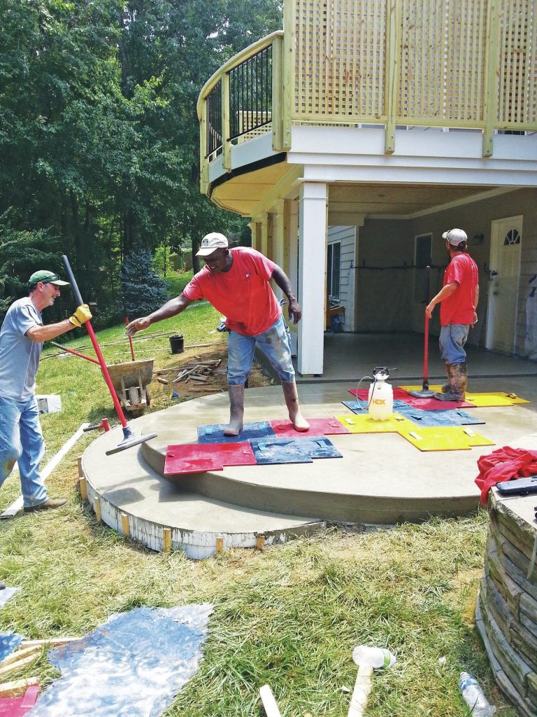

The overlay mix consists of sand, cement, and polymer resins that provide the finished surface with flexibility and impressive strength. Stampable overlays are typically applied with a gauge rake and add up to about an inch of thickness to the slab. The coating can be colored, and flexible stamping tools can be used to duplicate the look and texture of virtually any material, including stone, tile, and even wood.

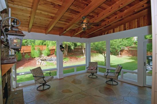

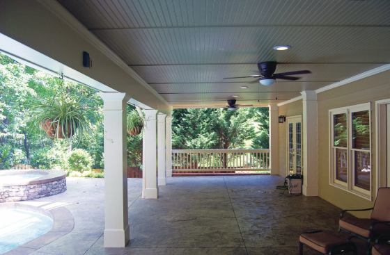

Stamped concrete. A newly-poured concrete slab can also be colored and stamped. A stamped concrete patio costs about twice as much as standard concrete in my area, or about $9 to $12 per square foot, which includes the site work and forming.
Like any concrete slab, a stamped concrete installation will require expansion joints (relief cuts to control cracking). When discussing this option with clients, I point out that small round patterns will be visually impacted by the straight expansion joints, and should probably be avoided. These cuts aren’t quite as problematic with large circular patterns, and are least noticeable with large square or rectangular patterns. Depending on the pattern, the expansion joints can even be an asset, making the surface look like it’s composed of large slabs of slate or granite.

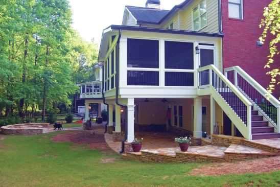

Pavers. Pavers made of stone or concrete are another option we offer. They’re installed over a properly prepared sand or crusher base, and in my area typically cost about the same as a stamped concrete patio. We don’t install a lot of paver patios, partly because we haven’t yet found a great paver guy to work with.

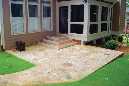

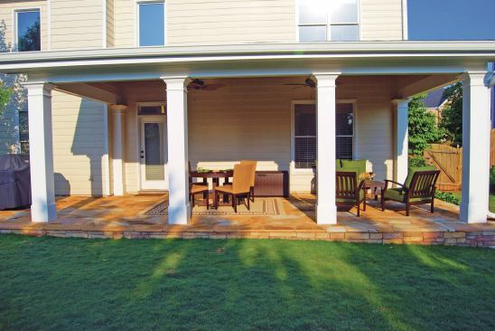

Flagstone. When cost isn’t a concern, most of our clients prefer flagstone patios. Natural flagstone makes a great patio and open-air porch surface that mixes well with retaining walls, fire pits, and other hardscape options. I steer clients away from using it in screened porches, though, because its uneven surface will create gaps between the floor and the wall plates. In our market, a flagstone patio costs at least $15 per square foot—three times as much as poured concrete. This price assumes that the flagstones are set in mortar over a concrete slab, rather than dry-laid over a crushed-stone base.
When the design permits, we like to provide paver or flagstone porch floors with a defined edge. Raising these hard surfaces about 6 inches above grade rather than leaving them flush with the sod provides better drainage and makes mowing and trimming easier.
