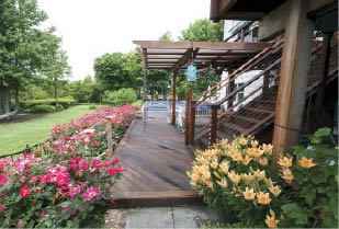

The deck is built, the tools are back in the truck, and the job is done. But wait, not so fast. What about the landscaping? A new deck can look pretty stark surrounded by nothing but exposed soil. This is probably not what your clients had in mind when they signed on. You may say “That’s not my problem,” but you could be leaving money on the table, as well as leaving your customers not quite as happy as they could be. Why not put in a little extra effort? Landscaping your decks is a way to enhance your offerings and set yourself apart from other deck builders.
Photo: Clemens Jellema
There are two ways to integrate landscaping into your business. The first is to develop relationships with landscaping contractors and offer to include their services with your bids. You can make a few dollars by marking up their bill, and you don’t need to learn the trade yourself. Or, you can do some research and learn enough about landscape design and installation to offer your own package, tailored to your climate.
