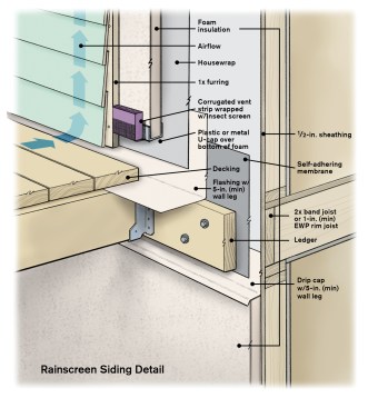

Homes with exterior insulation also often have rainscreen siding. When removing the exterior foam to install a deck ledger, provide adequate clearance between the siding and the decking to maintain airflow. A series of small holes poked in the U-cap protecting the cut edge of the foam allows for drainage should water ever collect there.

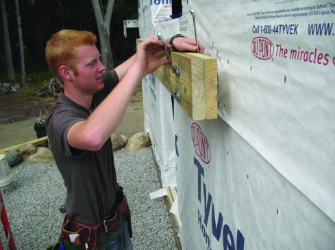

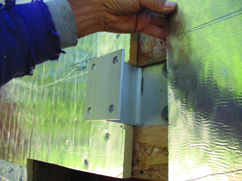

The easiest option for fastening ledgers to walls with thick foam on the outside may be to simply remove the foam and install the ledger directly to the rim joist (or over the structural sheathing covering the rim joist). There’s nothing unusual about the process; it’s the same as removing siding on an existing house to install a ledger. Just think of the foam as extra-thick siding.
Maine Deck Brackets are bolted directly to the rim joist, so the first step is to cut out the wall sheathing and through-bolt the wider flange to the rim.
Mike Guertin
If you choose this approach, the wall leg of the ledger flashing needs to extend behind the foam insulation—I prefer that the leg reach at least 5 inches up the wall. To protect the foam from damage and from burrowing pests, I cap the exposed cut edges with a U-shaped metal or plastic channel with 3/4-inch or longer legs.
Clearance is also needed between the surface of the finish decking material and the insulation. I usually make the clearance space 1/2 inch greater than what the cladding manufacturer requires—for example, for Hardie fiber-cement siding, I cut enough insulation to create a 2 1/2-inch gap above the decking; for vinyl siding, 1 1/4 inches; for wood shingles, 1 inch; and so on. The extra clearance allows the siding to overhang the insulation 1/2 inch and hide the foam edge.

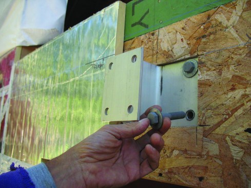

The foam panel is cut to fit around the bracket web. The brackets can accommodate foam up to 3 inches thick.
Mike Guertin
Many walls that have exterior rigid foam insulation also have rainscreen siding, where there is a vented air space between the exterior cladding and the foam. When you’re retrofitting a ledger onto a rainscreen-style wall, it’s critical to maintain those air spaces both above and below the deck surface (see illustration, above).

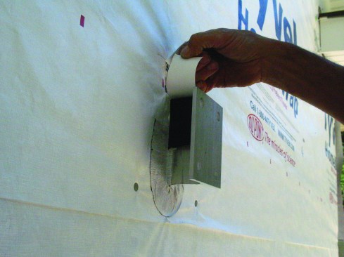

The brackets can be waterproofed with flexible flashing tape bonded to the web and the housewrap covering the foam panels. Apply the tape shingle-style, so that the top piece overlaps the bottom piece, as shown.

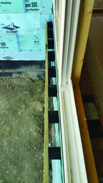

Some homes are now framed with insulated rim boards, where the structural rim is inset 1/2 inch to 21/2 inches or more from the exterior wall plane, and the recess is filled with a layer of rigid foam. Because structural sheathing typically covers the wall studs, foam, and mudsill as well as the rim joist, it may not be obvious when an insulated rim board is present, though you will notice the soft foam when you drill a pilot hole for a lag screw or a clearance hole for a through-bolt. But when using structural screws (which don’t require pilot holes), you may not notice the foam layer—and could end up connecting a ledger to nothing.

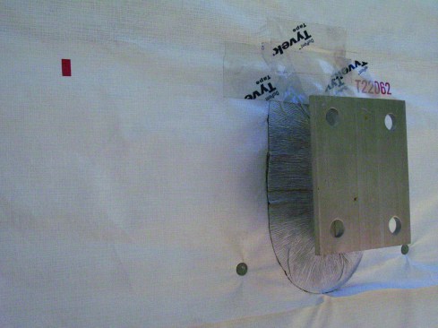

To seal the bracket to the housewrap and prevent leaks, the author applies another layer of tape over the top of the flexible flashing tape.
Mike Guertin
The only way to determine if there is an inset rim joist is to probe with a drill bit before mounting the ledger. If the rigid foam is only 1/2 inch thick and the wall sheathing is only 1/2 inch thick, then the deck ledger can still be installed directly over the sheathing without any additional work (per IRC Table 507.2, referenced above).
In order to mount a deck ledger where the rim joist is insulated with a thicker layer of foam, however, solid wood blocking (essentially a secondary rim board) must be installed between the rim board and the sheathing. The blocking must be fully supported by the mudsill or wall plate at areas where the ledger will be situated.
Ideally, on a new house the framer can skip the insulating foam and flush the rim board with the mudsill in the area where a deck will be mounted. But when a deck is built onto an existing house that already has an insulated rim board, the deck builder has no choice but to remove the structural sheathing and replace the rigid foam with solid blocking before resheathing.

The ledger is a double 2-by that’s through-bolted to the outside flanges of the brackets. Bracket spacing is determined according to the manufacturer’s specifications and the loads on the deck.

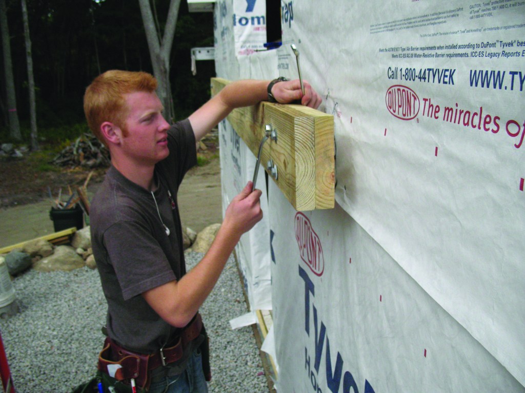

The Maine Deck Bracket and the BR Brick Bracket weren’t designed as solutions for mounting deck ledgers on walls with rigid foam insulation, but they do the trick. Both are structural spacers that can bridge about a 4-inch gap between a rim board and a ledger. They can be installed in new construction or retrofit onto existing homes with only a little extra work cutting back the siding and insulation. Because both brackets mainly address vertical loads, lateral load connectors may still also be required.
The Maine Deck Bracket is an H-shaped heavy-duty aluminum extrusion (deckbracket.com). One side of the “H” through-bolts (no screws) to the rim board with 1/2-inch hex-head galvanized bolts; the ledger is then bolted to the other side of the bracket. The web is a 1/4-inch-by-3 3/4-inch bridge that can be insulated and clad around. I’ve used this bracket on several jobs with foam sheathing and on other challenging ledger installations where the extra space between the ledger and the rim is needed (Figures 1 through 5).
To determine the spacing of the brackets, I first do a deck-load calculation to determine the pounds per linear foot of tributary load on the ledger. Referring to the Maine Deck Bracket’s ICC-ES Report, which provides maximum loading information, I divide my calculated number by 1,000 pounds (for a single, 1 1/2-inch rim joist) or 1,160 pounds (for a double, 3-inch-thick rim).
For example, a 12×20 deck with a clear joist span (wall to beam) of 11 feet has a tributary area of 5 1/2 feet by 20 feet, or 110 square feet. The tributary load is therefore 110 sf. x 50 lb./sf. (40-lb. live load + 10-lb. dead load), or 5,500 lb. Dividing 5,500 lb. by 1,000 lb. then yields 5.5 (rounded up to 6). This means that six Maine Deck Brackets, spaced equally along the length of the ledger, would be required for this deck.

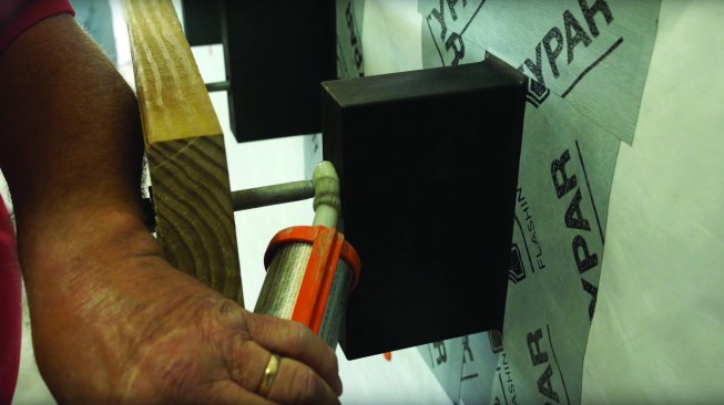

Another option is the BR Brick Bracket, which was designed to bridge the space between the wall sheathing and the ledger on homes clad with brick veneer (brbrickbracket.com). While the product has no ICC-ES Report yet, the inventor has had the system tested by an engineering service. These plastic brackets space a deck ledger a little more than 5 inches off the face of the wall sheathing and are installed with through-bolts running through the ledger, the brackets, and the rim board. They can be installed in new construction or on retrofits.
BR Brick Brackets are connected to the rim joist with 1⁄2-inch-diameter through-bolts. The bolt hole is filled with sealant prior to installing the bolt to prevent water intrusion.
BR Brick Bracket
A table (similar to the joist-span table in the IRC) provided by the manufacturer can be used to determine the spacing requirements for the brackets. But before using the brackets, make sure your local building official will accept the manufacturer’s independent engineering.
