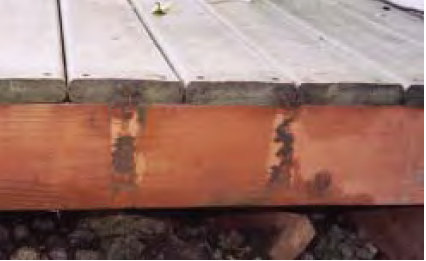

Eliminating Collection Zones
On this deck, water got between the fascia and rim, partially rotting the fascia and completely destroying the rim.

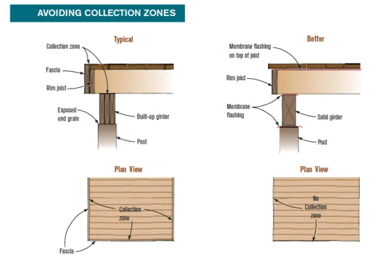

Fascia Detail
A perfect collection zone is where the fascia board rims the deck. There’s no airflow between the fascia and the framing, so the 21 percent moisture content required for rot can be maintained over long periods of time, and there’s no way for debris to escape. But if you simply cantilever the deck boards one inch over the fascia you reduce the number of places dirt and moisture can get in. Compare these construction details by looking at how many linear feet of collection zone each design creates. On a 12-foot-by-16-foot deck with 6-inch deck- ing, a fascia that is flush to the top will create 40 linear feet (12 + 16 + 12) of collection zone (the entire perimeter). But if the decking laps over the fascia, the collection zones are limited to the 1/4-inch gaps between the deck boards, a cumulative 121/2 inches. Using a belt and suspenders approach, you can also seal the top of the rim and fascia with peel-and-stick mastic, like Grace’s Vycor Deck Protector, or with a liquid membrane by Whale Glue.
Wrapping a 12-foot-by-16-foot deck with fascia (left) creates 40 linear feet of potential collection zones, where rot-encouraging debris gathers at the rim joist. Running the deck boards parallel to the house and overhanging the fascia (right) will reduce the collection zones to a cumulative 121/2 inches (1/4 inch per gap x 50 gaps). While some water and debris will get in, the greatly reduced amount will be much less likely to cause rot.
Built-up Beams
It’s common practice to double- or triple-up 2-by material to form beams. Unfortunately, the space between the pieces creates a collection zone. A better practice is to use solid 4-by or 6-by beams to carry loads. Still better is to cap the beam, whether it’s solid or built-up, with copper or a membrane such as Vycor.

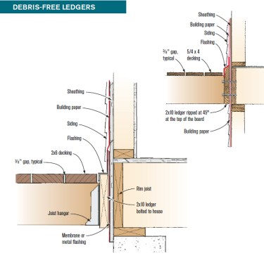

Attaching Ledgers

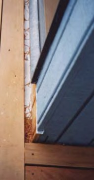

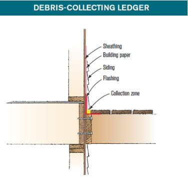

Another common building practice (and IRC requirement) is to use flashing to keep moisture from getting between the house and the ledger. Many contractors will install an L-shaped piece of metal here; the horizontal leg covers the top of the ledger, and the vertical leg goes up the wall and is lapped by the building paper above.
It’s common practice to bring an L-shaped flashing down the wall and kick it out over the ledger, the resulting pocket can collect debris.
The problem is that rot can invade the deck board or the bottom of the siding when organic matter builds up in the space between the deck and the side of the house — especially on the wind-driven side of the house. The rain hits the siding and runs down into this collection zone, where organic matter creates a kind of dam, preventing drainage. If the siding is not up off the deck, the water will soak into the backside of the siding, and from there can enter the house via capillary action.
One way to overcome this problem is to use a ledger that is larger than the joists. If you’re using 2×8 joists, you need a 2×10 ledger. Bevel the top of the ledger and install it 11/2 inch higher than the joists. Install the first deck board 3/8 inch to 1/2 inch away from the ledger to allow the organic matter and water to drop through to the ground.
Keeping debris from collecting against the house is key to a long-lasting ledger connection. A sloped and flashed ledger (above) sheds water and debris. A properly flashed flat ledger that’s flush with the decking (left) is another easily cleaned connection. Keep siding 2 inches above the ledger with this design.

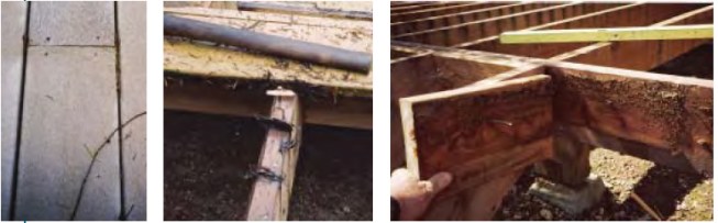

Many carpenters use 16-penny nails to space deck boards. This creates a 1/8-inch-wide gap that forms a collection zone between boards and on top of every joist. It’s nearly impossible to remove leaf litter from such a narrow gap. And once the organic matter is in there, it can induce rot in the deck boards and in the joists below.
Most carpenters space deck boards too tightly (left), leaving enough room for debris to get in but no way to clean it out. On this deck, organic matter collected at every gap and joint (center), as well as between a rim joist and blocking that landed under a gap in the deck boards (right).
My way around this problem is to install decking with a wider, 3/8-inch gap. Organic matter won’t collect in this larger space, but will simply fall through. (Some customers express concerns that such a wide gap will catch a woman’s high heel. I’ve found that once I explain the benefit — extending the longevity of the deck — they readily accept the gap. And how many women wear stilettos to a barbecue?) The larger space also allows air to circulate and dry out the decking and joists. And on top of joists, where debris still collects, the space is wide enough to be raked clean with a screwdriver. The same rules apply to composite decking; even though captured organic matter may not affect the composites, it can still rot the framing below.

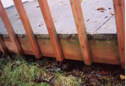

Many carpenters nail 2×2 balusters to the fascia or rim joist, a poor practice because there are so many nails in the rim that it ends up looking like a pincushion. The large number of fasteners can also split the rim and allow water to get inside. Any railing system that attaches to the top of the deck, on the other hand, is less likely to create a collection zone, especially if the bottom is caulked.
Nailing balusters to the rim joist creates pockets.
These pockets trap moisture and debris, which can cause rot.
Some railing systems need to be attached through to the deck framing. If this is done inside the rim you create collection zones on two sides, if not all four sides, of the posts. If you attach your post to the outside of the rim, you cut your collection zone by as much as 75 percent.

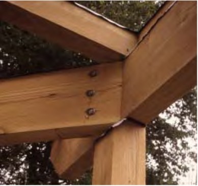

There are a couple of commonly used, yet unwise methods for connecting posts to beams. One is the practice of notching the posts for beams, which creates a collection zone. Another is scabbing on a piece of scrap decking board — this is like setting the table and inviting fungi to dine! The solution is to use one of the numerous Simpson post-to-beam connectors, such as the BC4 or the 1212HT.
