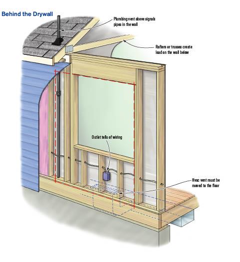

Inside the Wall
When I tackle a wall or window conversion, I know the project will pull me in a lot of directions — from rough carpentry right through persnickety trim details and painting. Most of the items that follow will need to be addressed and detailed in your permit application. In some cases, the building department will require an engineer’s stamp before granting the permit for structural work. Sometimes you get lucky, and the rough-opening width of an existing double window will also serve for a 6-foot slider. In that case, the existing framing is probably fine. Your biggest concern will be removing the siding, drywall, trim, cripple studs, and bottom plate beneath the window — all fairly basic — and replacing it all with a door unit. The main issues then are the flashing outside and the trim inside. Usually, though, the job is more complicated. Plumbing. The first part of evaluating the job is easy: First look up, then down, for plumbing (Figure 1). If there’s a bathroom above, it’s even money there will be plumbing in the outside wall. Less obvious is when there’s no bath above. If plumbing vents penetrate the roof above the proposed opening, there may be a bath or laundry room below that vents through the area you’re planning to change. Try to get up in the attic to see where the vent comes from. You may have a lot of plumbing to deal with. In the Northeast, hot-water baseboard heating is pretty common. If that’s the heat source, odds are there’s a radiator right where the door will go — one more reason it’s important to have a good plumber in your address book. Electrical. There’s about a 100 percent chance that wires run through the exterior wall. They’ll need to be properly rerouted. Any wires that are terminated need to end in a junction box that’s accessible, not buried in the wall. Sometimes that can be a plus for your customer, as the electrician might be able to handle the junction in a new outlet box. In any event, at least one outlet will probably have to be added to meet the code requirement of an outlet within 6 feet of each side of a door. Also, you’ll probably need to add an outside light and a switch for it; depending on your local building department, you may need to add a switch controlling an indoor light by the door as well. It may be cheaper to add a new light than to wire in a new three-way switch to an existing light. If the house is heated with electric baseboards, one is usually in the way. So while the electrician is working on the lights, have him take care of the baseboard unit too. Hvac. In my experience, there’s an 80 percent chance an hvac supply is in the floor or the wall beneath an existing door or window. If the vent is in the wall, you’ll need to move it to the floor. It’s not easy to get an hvac contractor for a job this small, so I often end up doing it myself. It’s not difficult if there’s access from below. If there isn’t, you have to open up the ceiling below, which means more drywall and painting. Changing the vent is pretty straightforward. Once you measure the size of the duct, head to your local hvac supplier or big-box home center and buy a floor boot and some duct tape (the good stuff that’s got an ICC listing, not the regular fabric duct tape your old boss used to hold together his tool pouch). Unscrew the existing ducts, cut a hole in the floor for the boot, cut the duct to length, and reassemble. Or when typical materials don’t fit, make your own with aluminum coil stock and a sheet metal brake — which is usually what I end up doing. Be sure to tape the seams — leaking ducts are big energy wasters. The exposed vent apparatus is usually a louvered metal contraption with a lever that sits proud of the floor and thus is easily mangled. Beneath a window, where there’s limited traffic, the lever is fairly safe. In front of a door, however, a flush-mount unit is necessary (Figure 2). If there’s carpet, set it on top of the carpet. For wood floors, the right thing to do is match the species and stain the grille before installing it. I use Cape Cod Air Grilles (800/547-2705; ccairgrilles.com).
When an hvac grille has to be moved from the wall to the floor, you can buy a cheap metal grille at any home center, or you can class up your project with a hardwood grille to match the flooring.
The cutout in the floor needs to be right on the money. I use a straightedge and a circ saw. Consider the vent location when you decide which side of a wide door will be the active one. The vent will last considerable longer if you place it in front of the inactive door.

Check the roof type. A gable or gambrel roof drives most of its weight down through the walls that carry the rafter tails. This load path goes through studs, headers, and floor framing all the way to the foundation. The walls that don’t carry rafters (the peaked side) usually carry a lighter load. A hip roof drives most of its force down the corners of the building, but all four sides also carry significant roof weight. In two-story houses, the first-floor walls that are perpendicular to the floor joists also carry floor loads (these walls are usually the ones carrying the load of the roof). In general, I assume there’s a load from above and support the ceiling with a temporary wall. A masonry or block wall carries not only the roof load, but also the weight of the block, brick, or stone above the opening. Here, you’ll probably want to hire a specialist to cut out and properly reinforce the wall. As an added benefit, these contractors usually cart away the half ton of masonry they remove. The International Residential Code will stipulate minimum sizing requirements for a header and jack studs (the studs the header rests on), based on the configuration of the house. The key word is minimum — you can always overbuild. Check the code, but in most cases, the opening for a 6-foot door or window can be headed off with a double 2×12. I pack it out with a strip of 1/2-inch plywood so the header matches a 2×4 wall thickness. If it’s a 2×6 wall, you can add a piece of 2-inch rigid foam to insulate the header. You’ll need double jack studs under each end of the header. In an 8-foot-high wall, the 2×12 header usually provides exactly the proper rough-opening height. With higher walls, you’ll probably need to add cripple studs above. Shorter walls can be a problem, because sometimes there’s not enough room above the door for the requisite header depth. It may be necessary to spend a few hundred bucks on an engineer. One alternative is to use engineered lumber such as LVL for the headers. In many cases, the supplier will provide the engineering with the purchase. A second alternative is to use a steel plate in the header, but here you’ll almost certainly need engineering.
Open the Wall
Before cutting into the wall, I build a temporary stud wall, usually 8 feet long, of 2x4s 24 inches on center (Figure 3). To protect the ceilings and floors from damage, I wrap the top and bottom plates with carpet samples, then wedge the temporary wall in tightly between the floor and the ceiling to prevent movement. It will probably leave marks on the drywall, but guess what? You’ll be painting anyway. If you’re lucky, the homeowner has some touch-up paint stashed away. If not, save a scrap of the drywall you remove for color matching at the paint store. Working inside someone’s home is a whole different kettle of fish from working outdoors. I can’t tell you the number of times I’ve had to remind carpenters — despite the presence of the homeowner and the furniture — that someone lives in the house. Drop cloths from the entry door into the work area can’t hurt, but the main thing is to protect the house from demolition dust and the floors from scratches. Attach thin plastic sheeting to the temporary wall, ceiling, and outside walls with masking tape to control interior dust. I often bring a Delta air cleaner ( deltaportercable.com) to the site to knock down airborne dust (Figure 4). Nothing’s perfect, but every little bit helps. If there’s a window, take it out and use that opening as access, staying mostly out of the customer’s house. If the window will be out overnight, have a piece of plywood ready to board up the opening.
