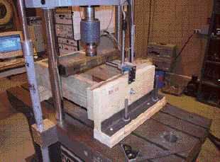

Researchers at Virginia Tech University and Washington State University tested simulated deck ledger-to-house band joist connections. The testing included a practical range of pressure-preservative-treated (PPT) deck-ledger lumber (incised hem-fir and southern pine) attached to a simulated spruce-pine-fir band joist by 1/2-inch lag screws or bolts with washers. The deck ledger was separated from the band joist by a piece of 15/32-inch wall sheathing. In a separate test for bolts only, a 1/2-inch stack of washers was inserted between the ledger and the sheathing to produce a drainage plane.
Figure 1. Researchers at Virginia Tech used this hydraulic apparatus to test the strength of various ledger-to-house connections.
The specimens were tested to failure (Figure 1); average test results were divided by a factor of 3.0 — intended to provide an adequate in-service safety factor — and further divided by 1.6 to convert from a “test duration” to a “normal duration” of 10 years, which is recognized by the International Building Code as the proper duration for occupancy live load. The findings, nationally published in “Wood Bits: Residential Deck Ledger Design” in Building Safety Journal (December 2005) and “Load-Tested Deck Ledger Connections” in The Journal of Light Construction (November 2005), were the basis for the recently approved code change.
