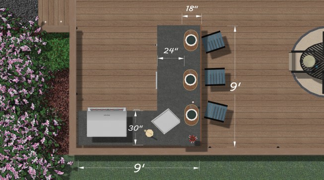

We work directly with clients to design their kitchen. Most have a hard time visualizing what they are trying to achieve, so the 3D renderings we create using Realtime Landscaping Architect (reviewed in the October 2021 issue of JLC) are invaluable during the process.

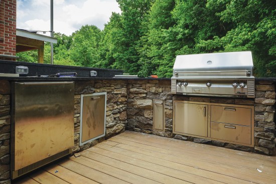

We start with basic requirements—location, size, privacy concerns, sun exposure, view—and then move to appliances. The main components in most of our designs are a built-in grill with storage below, a fridge, and additional storage. Sometimes, clients think they want an outdoor sink too, but after a conversation about the advantages and disadvantages, often they decide that the added convenience is not worth the extra cost. In fact, most of our outdoor kitchens don’t include a sink; instead, we install a built-in ice bin.

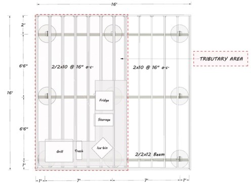

To help his clients visualize the design of their new kitchen, the author uses a CAD program to create 3D renderings, including an overhead view with dimensions (above). As shown in the framing plan (right), doubling the joists in the tributary area where the kitchen is located accommodates the added weight of the kitchen appliances and cabinetry.
Once we’ve settled on a rough layout, I create a preliminary 3D rendering with views from different angles, together with an overhead view showing the dimensions. When the plan has been approved, I fine-tune the rendering by adding outlets and light fixtures and adjusting the stone and granite selection.
After we agree on the cost of the project and the contract is signed, I complete the construction drawings and submit the plans to the county permit office for approval.

Sometimes the kitchen will be located at grade over a concrete patio, in which case the enclosure walls can be built with 6-inch CMUs. But when the kitchen will be installed on an elevated deck, we frame the kitchen with pressure-treated or galvanized steel studs. Even so, the standard 50-pound-per-square-foot design load for an outdoor deck is not sufficient to also support the weight of an outdoor kitchen. Not only do the framing, finishes, and equipment add weight, people tend to gather around this area more.
As a rule of thumb, we double the design loads for the tributary area where the kitchen is going to be installed, so that the dead loads are 20 pounds (instead of 10) per square foot and the live loads are 80 pounds (instead of 40) per square foot. As a result, joist and beam spans are reduced, while the size of footings is increased. To make sure the deck will be strong enough, I have the final plans reviewed by an engineer for approval (see floor plan, above).

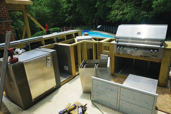

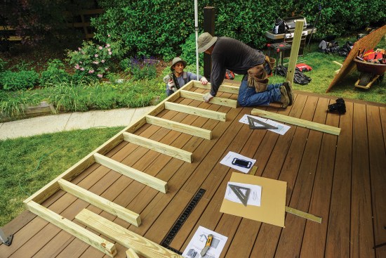

Before construction of a kitchen can begin, we make sure all appliances that will require a rough opening are on site. This includes things like storage drawers and ice and trash bins, as well. That way, we can lay out the walls confidently, using cardboard templates cut to the rough-opening requirements of each appliance instead of relying on printed specs.
To assist with laying out the kitchen framing accurately, workers make cardboard templates sized to fit the appliances.

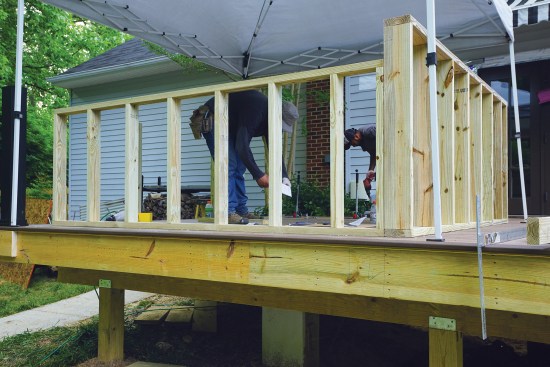

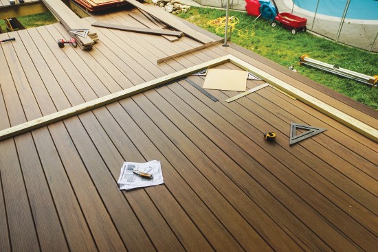

Prior to installing the decking where this kitchen would be located, we covered any doubled joists with 4-inch-wide G-tape acrylic flashing tape to prevent water from pooling between members. We also installed horizontal blocking between the joists where the perimeter walls for the cabinetry would be located.
We framed the kitchen’s perimeter walls with pressure treated 2×4 studs 16 inches on-center, and the bar wall with PT 2×6 studs 16 inches on-center, joining the framing together with 3-inch ring-shank galvanized nails and 3-inch structural exterior screws.
Workers frame the kitchen’s perimeter walls on the deck with pressure-treated 2x4s and 2x6s.
After standing the framed walls up, they screw them through the decking into blocking installed between the joists.
We framed the counter walls so that the finished height after the stone countertop was added would be 38 inches, rather than the standard 36 inches (I like to think bigger when designing and building outdoor kitchens, both in height and in square footage, to provide extra room for seating, grilling, and dining). We framed the bar wall at 46 inches so that it would be 8 inches higher. We always slope the framing for drainage so that there won’t be any standing water on the countertops after a rain shower.
After we framed the walls on the deck, we set them in place and made sure they were level and plumb. Then we used 4-inch exterior structural screws to fasten them to the horizontal blocking installed beneath the decking. As we built the walls, we used cardboard templates cut to the rough-opening requirements of each appliance and accessory to make sure everything would fit, making adjustments as needed. This can be done either before or after the perimeter walls are built.
Clearances for appliances are usually specced by the manufacturer, but in general, we plan on at least 1/4 inch of space on each side of an appliance. For refrigerators, we leave a clearance of at least 1/2 inch on each side and 1 inch in the back to maximize ventilation.
Utilities. After all the framing was completed, we scheduled the electrician to do the wiring. We like to include at least one or two outlets at the raised bar and one under the cabinet for a transformer for low-voltage lighting. All the wiring is UF-B outdoor-rated cable, which we secured with stainless steel staples where we didn’t run it through conduit.
On this project, we included three low-voltage LED light fixtures under the bar, and six recessed floor lights in the work area. All are connected to the transformer that is plugged into an outlet inside one of the cabinets.

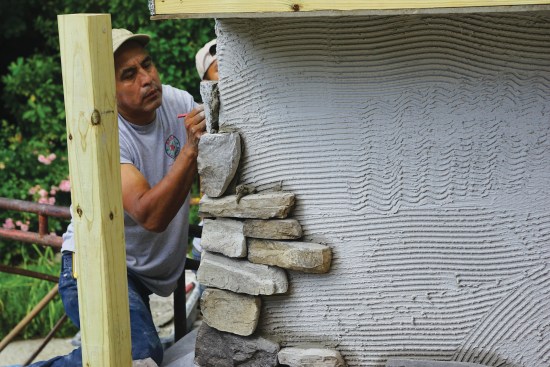

Stone-Veneer Finish
To create a substrate for the manufactured-stone-veneer cladding used on this project, we wrapped the framing with 1/2-inch Durock cement board secured with 1 1/2-inch screws 8 inches on-center. When cement board is used over treated framing lumber or plywood, we install a Class III (medium permeability) vapor retarder underneath the cement board, since it will retain moisture if it gets wet. Without the vapor retarder, any lumber next to the cement board will always be damp, especially when a kitchen is not covered by some sort of roofing.
To prep the walls for stone veneer, workers wrap the framing with a vapor retarder before installing cement board cladding.
After completing the cement-board installation but prior to installation of the stone veneer, we dry-fit the appliances to make sure they would go in smoothly. Then we removed them and put them in a safe area where we knew they wouldn’t get damaged and called the granite company to schedule a measuring for the stone countertop. On this project, the client chose BoraBora granite, a material that is cost effective (between $35 to $60 per square foot) and available in our area.

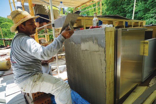

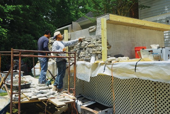

Our client chose Eldorado Shadow Rock manufactured stone veneer (in the color Chesapeake) for the cladding, and ipe for the bar top. We installed the stone veneer over a mortar scratch coat and galvanized wire lath, using stainless-steel roofing nails every 6 inches vertically and every 16 inches horizontally to secure the lath to the cement board.
We mixed up the scratch coat using three parts masonry sand, one part Type S mortar, and water. We let the scratch coat dry a full day before starting installation of the veneer stone.
Masons then trowel on a mortar scratch coat over galvanized diamond lath fastened to the cement board.
While stone veneer can have mortared joints, on this project the stone was dry stacked, with no mortar between the joints. Starting at the corners, the masons worked in 3-foot-by-3-foot sections, first arranging the stone for each section on a piece of plywood to find an aesthetically pleasing look. They used an angle grinder fitted with a diamond blade wherever a stone needed to be cut to fit or to give it a straight edge around an opening.
To set the stones, they used the same mortar mix as the scratch coat, back-buttering each one and pressing it into the scratch coat until a little bit of the mortar squeezed out.
After allowing the mortar to cure overnight, masons begin applying the manufactured stone veneer, starting at the corners.
The masons work in sections, back-buttering each stone and pressing it into the scratch coat.

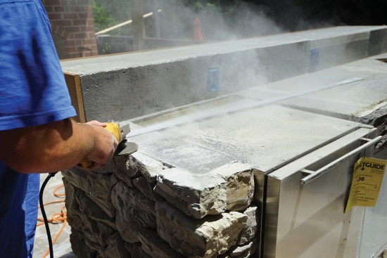

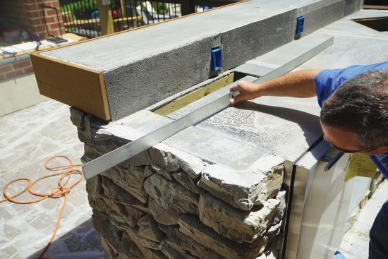

Prior to installing the granite countertop, the installation crew carefully checked the top of the cabinet surface with straightedges to make sure it was completely flat. Where necessary, a grinder was used to remove bumps and high spots to prep for installation.
Prior to installing the granite countertop, workers check the top of the cabinet surface with straightedges.
They use a grinder to remove high spots to make sure the surface is flat.

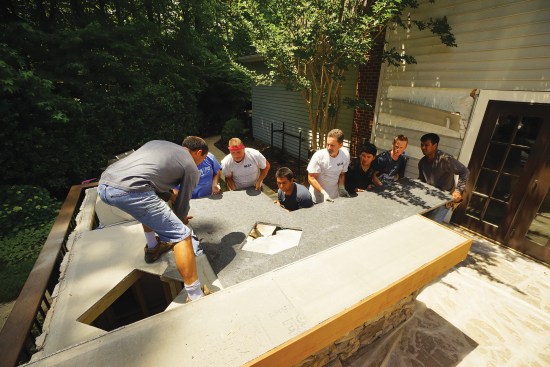

Granite is heavy and needs to be handled with care, so we rounded up as many workers as we could to help out on the day of delivery. Before lowering the countertop into place, we applied an ASTM C920 silicone sealant around the perimeter.
Before setting the heavy stone countertops, workers applied silicone sealant around the perimeter of the supporting surface.

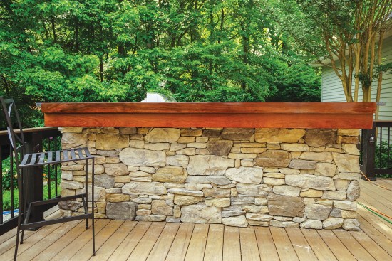

Finally, we covered the bar overhang with a 1×8 ipe board directly secured through the cement-board substrate into the framing with plugged screws and a dab of PL Premium exterior glue. We drilled 3/8-inch-diameter holes about 1/4 inch deep, followed by 5/32-inch-diameter holes the rest of the way through the wood. After driving the 2-inch exterior screws into the framing, we placed drops of exterior glue into the holes and filled them with 3/8-inch-diameter ipe plugs to give the bar top a finished look.
Ipe trim on the bar overhang offers a warm contrast to the stone veneer cladding.

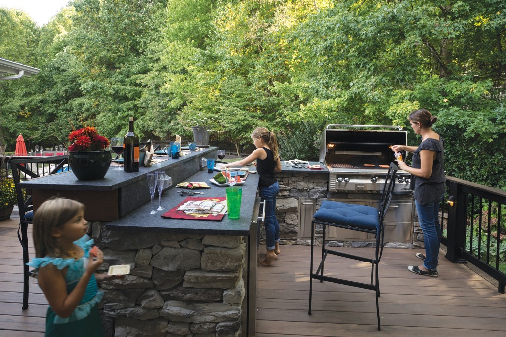

The main ingredients in most of the outdoor kitchens that the author builds are a built-in grill with storage below, a fridge, and additional storage.
