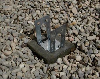

Elegant is not a word I would use to describe the round concrete footings that most decks are built on. The tops of these footings are much larger than is required for load bearing, so for the past eight years I’ve been shaping the tops of my footings into a sort of truncated pyramid to decrease their visible footprint (see photo, above).

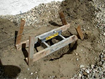

Figure 1. The form for the top of the footing is made from 1x4s fastened together at a slight angle. Four stakes support it and keep it level above the footing hole.
Before cutting the 1×4 into four pieces, I rip one face at a 5-degree bevel. When the form is assembled, the bevel will face inward to create the pyramidal shape of the pier. I cut the ends of the two cross members at 5 degrees to fit to the bevel on the long pieces; then I fasten the cross pieces to the long members 7 inches apart.
I use a string line as a guide to dig the footing holes and then to locate the centers of my homemade forms. I drive four stakes into the ground to suspend each form so that the top of the concrete will end up above finished grade to protect the posts from moisture damage. Once I make sure the form is level, I drive screws through the stakes into the form itself to hold it in position.

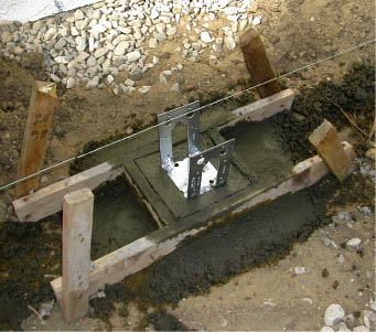

Figure 2. A string aligns the placement of a post base in wet concrete. Once the concrete has set, it will be easy to remove the form.
I tamp the concrete thoroughly and screed it flat at the top of the form. Before the concrete begins to set up, I insert the appropriate post or column base connector or hot-dipped galvanized J-bolt, again using the string as a guide (Figure 2). The next day, I’ll remove the fasteners holding the form to the stakes and lift the form straight off the concrete, ready for reuse.
