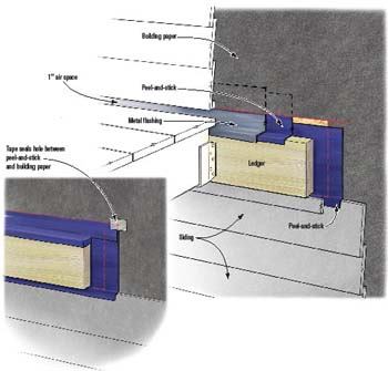

Flashing consists of metal – which is durable enough to be exposed to sunlight and mechanical wear and tear – plus peel-and-stick membrane like Vycor (Grace Construction Products; 800/354-5414, www.graceathome.com) or BT25XL (Protecto Wrap Company; 877/271-9661, www.protectowrap.com), which seals around punctures from nails and bolts.
Tearing into siding is all but inevitable if you build decks on existing houses. It’s necessary to remove (and replace) several courses of siding to flash a ledger properly; only then do you have access to lift the building paper and apply peel-and-stick membrane and metal flashing the requisite 6 inches up the wall (see illustration, above). Also removing a little siding beyond the left and right ends of the proposed ledger allows you to apply peel-and-stick membrane there to protect against leaks. The flashing can then lap the top of a lower course of siding, or the foundation, so any water that does get into the joint will be directed outward.

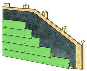

Face-Nailed Lap Siding
A number of face-nailed wood lap sidings – clapboard, Dutch lap, some hardboard panels, some engineered lap – can be easily removed and replaced, because the nails are accessible (Figure 1). The course overlaps are generally between 1/2 inch and 2 inches; face nails may or may not clear the siding beneath. When they do, removing and repairing siding is easy: You extract the face nails from any piece and pull it down and out. But more often than not, nails are driven through both the upper course and the top of the lower course, so you need to take extra care when dismantling to avoid splitting the siding.
Figure 1. Lap siding, such as cedar clapboards, is typically nailed through its face. When installing wood siding, you're supposed to drive the nails so they miss the underlying course, but more commonly they penetrate it. This can cause the siding to split over time, and it makes removal more challenging.

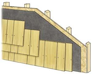

Shingle Siding
Because of the greater overlap and the blind-nailing pattern (Figure 6), shingle siding is more challenging to work with than lap siding. If having roughly two-thirds of the shingle body covered by the shingles above and being blind-nailed wasn’t enough, the nails holding the course above also penetrate the upper part of your target shingles.
Figure 6. Shingle siding is lapped in a way that means it's penetrated by two, and sometimes three, rows of nails. Because the individual pieces are much smaller than most other sidings, though, replacement of damaged shingles is simplified.

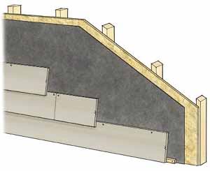

Blind-Nailed Lap Siding
Fiber-cement and several engineered lap sidings are similar to wood lap except they’re usually blind-nailed along the top edge (Figure 10). Also, they’re brittle: You have to be careful when prying to avoid breaking out the material around the fasteners, and you can’t use the slate ripper on nails in fiber cement because the siding tends to fracture during the process.
Figure 10. Most fiber-cement and engineered lap sidings are blind-nailed; that is, the nails are hidden beneath the lap of the upper course. When reinstalling such sidings, though, the last course will require face nailing, as there's no way to nail underneath the course above.

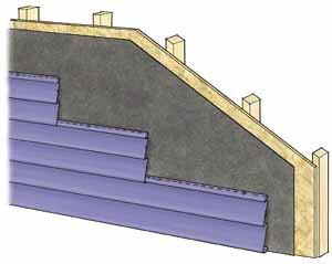

Vinyl Lap Siding
The simplest siding to remove, replace, and repair is probably vinyl lap siding (Figure 13) because you can unzip the overlaps – without pulling out nails. Use an unlocking tool like Malco’s SideSwiper, sometimes called a €œzip-lock€ tool (Figure 14). Hook the little €œJ€ end under the butt of the overlapping panel at the level where you want to begin removing siding. Once you push the end of the tool up, the hook will grab the lower edge of the lap. Slide the tool along the siding, pulling slightly toward you to disengage the lap.

Figure 13. Vinyl siding is one of the easiest sidings to remove and replace. Be careful if working in cold weather, though, as some vinyl becomes brittle.
