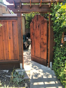

When a friend recently asked me to build him a garden gate out of old-growth redwood, I immediately thought of my stash of now-dry redwood. Far from clear lumber, the weathered slabs were highly figured with knots and checks, perfect for the Nordic-style door I had in mind. My design was inspired by my travels in Scandinavia—in particular, a curved detail at the top of the door (above).

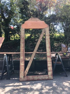

I built the inner frame out of 2×6 PT lumber, sizing it to fit the garden arbor that I had built earlier. I joined the bottom rail to the stiles with mortise-and-tenon joinery reinforced with four countersunk 6-inch structural screws at each joint—two in each direction—and Titebond III glue. At the top, I freehanded the curved detail on the 2×12 redwood rail, adding a short PT 2×6 to complete the design. After joining the top rail to the frame with biscuits, screws, and glue, I fastened a diagonal 2×4 brace to the frame to keep the door from sagging (below).

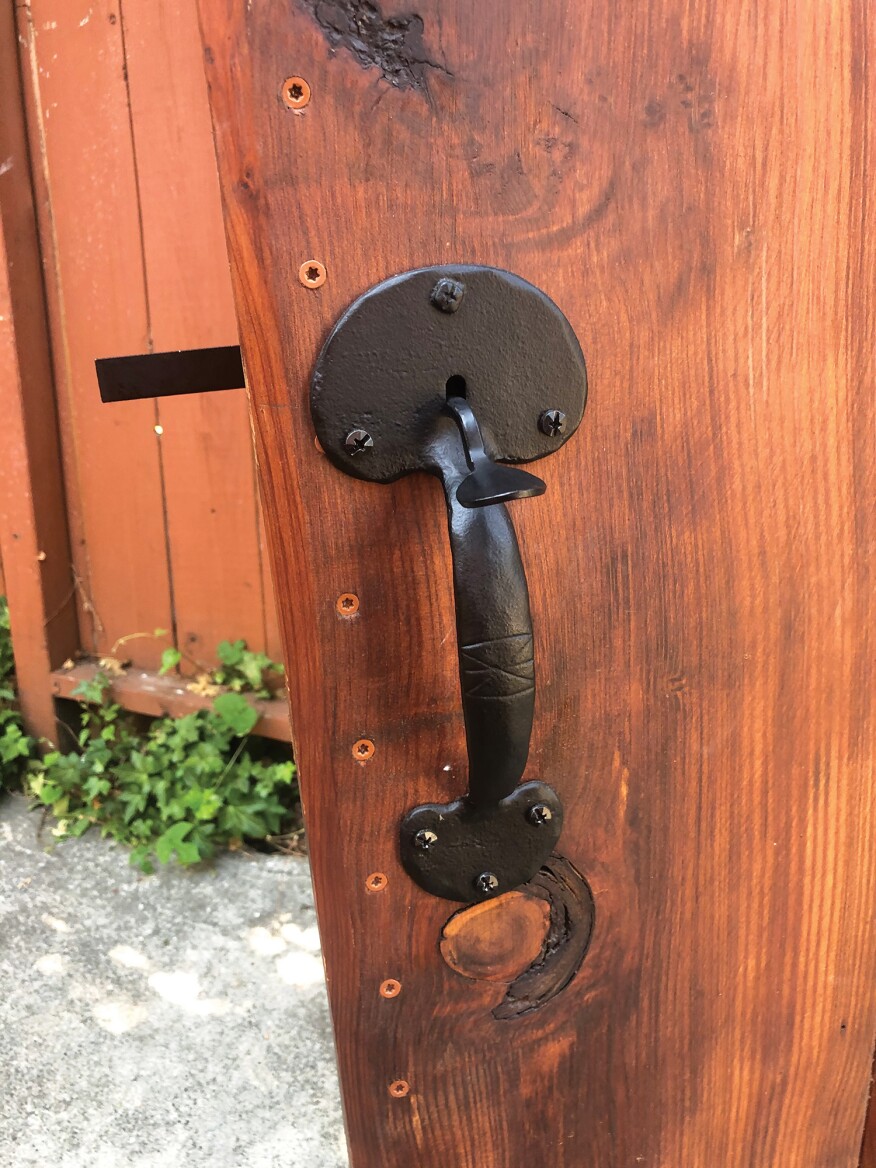

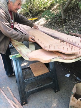

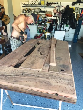

Among the door’s unique features are the dozens of screws used to fasten the outer boards to the inner frame (below left). I wanted to create an old-world rivet look, so I used a T-square to carefully lay out fastener locations uniformly spaced 1 inch on-center. Then I drilled counter­sunk pilot holes for the screws, which I partially inserted into the holes prior to final glue-up to speed up assembly (below right).

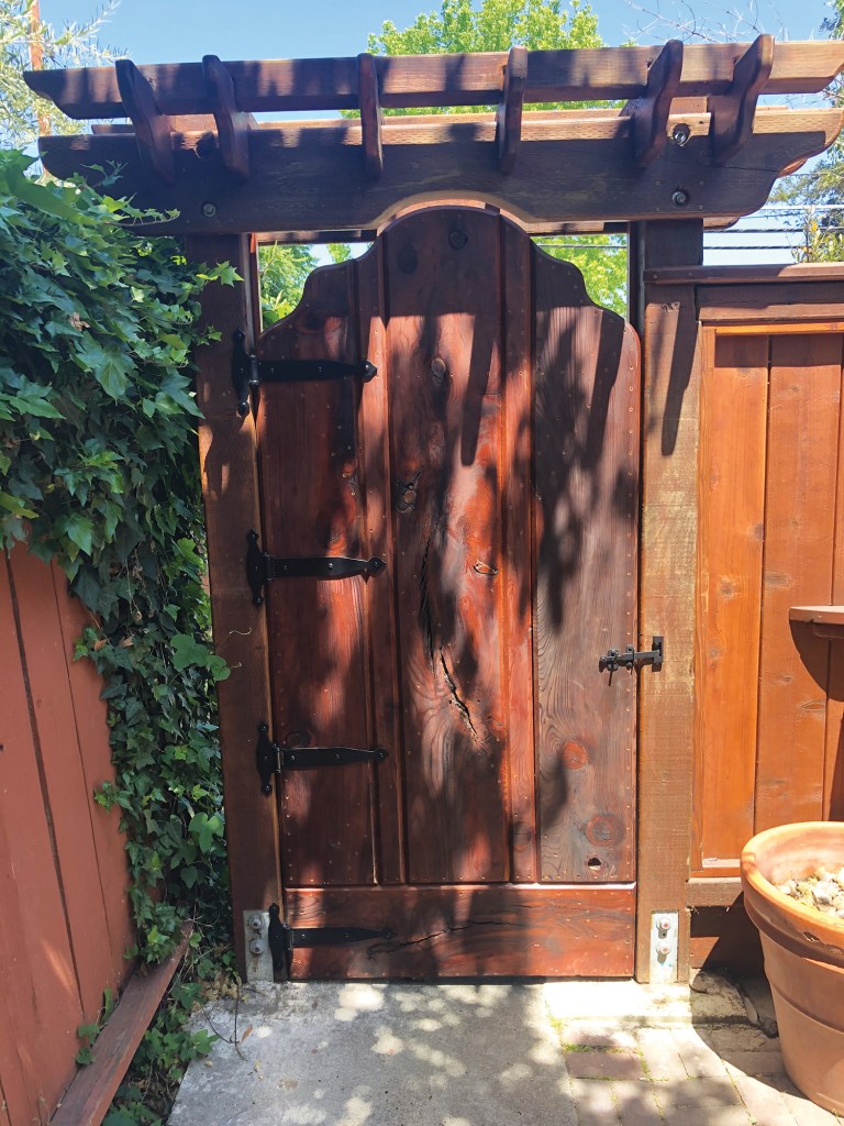

As I glued and screwed the boards to the frame, I snugged them together with bar clamps for a tight fit. After assembly, I gave all sides of the door three coats of PPG ProLuxe (formerly Sikkens) transparent matte finish to bring out the redwood’s beautiful grain and color. To match the door’s rustic look, I sourced hand-forged gate hardware and four giant carriage hinges that were made in England but stocked by a local supplier.
Heavy-duty hinges were required since the assembled door weighed more than 250 pounds; I was happy that my friend was able to help me install his new Viking gate in the arbor (above). ❖
