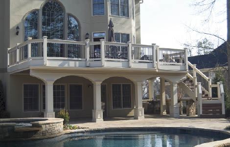

Working with yard angles and offsets on the house is another way to add wow to a deck. Incorporating small bump-outs not only avoids long, boring, straight lines but also assures function where bay windows, offsets, or a fireplace would otherwise reduce the deck's area (Figure 1).
Figure 1. A deck that follows a house's contours is more memorable than a budget, rectangular deck and doesn't cost a lot more to build.
