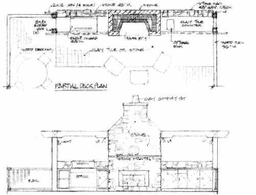

Combined Fireplace and Cooking Area
This fairly high-budget approach is great for clients who hold large parties, as it allows for cooking, eating, fire watching, and conversation. A two-member trellis on each side of the fireplace creates a semi-covered area, complete with grill, wet-bar, and storage cabinets. Built-in lighting and clay-tile counters that match the cooking-area decking refine the look.
