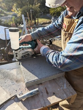

The Makita XCC01Z 18v LXT Cordless Masonry Saw solves both of those problems. To keep dust down, it has two systems for running water over the spinning blade. The first is a simple gravity system that employs a small, 12-ounce tank attached to the top of the blade guard (1). Water flows from the tank into a tube and over the edge of the blade. By rotating a lever on the blade guard, you can control the rate of flow or cut it off completely between cuts. This system works well, with only one drawback: The tank must be refilled frequently. So, Makita provides an optional hose that can be attached in place of the tank and connected to a garden hose or, with an adapter (not included), to a sink faucet.

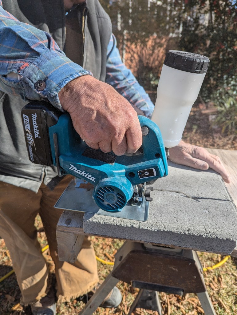

A 12-ounce bottle provides adjustable water flow to keep down dust. For constant water feed, a hose attachment can be used instead. Depth of cut on the compact, 6.6-pound Makita XCCO1Z can be set with its adjustable baseplate.
To regulate the depth of cut, the tool is configured like a standard circular saw with a table that can be locked in place or tilted for beveled cuts (2). A built-in LED makes the cut line easier to see. The saw has a 5-inch diamond blade and a maximum depth of cut of 1¾ inches at 90 degrees. The saw can cut right through granite slabs, brick, and concrete pavers. It goes through batteries quickly, however, so it’s best to have at least two batteries and a charger handy.
