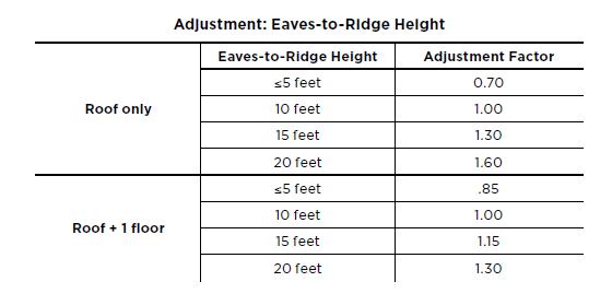

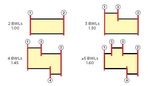

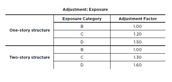

After finding the required bracing length in Table R602.10.3(1), you need to multiply that number by four adjustment factors.
After finding the required bracing length in Table R602.10.3(1), you need to multiply that number by four adjustment factors. Included here are the factors for one- and two-story structures. For three-story buildings, refer to Table R602.10.3(2) in the IRC.
