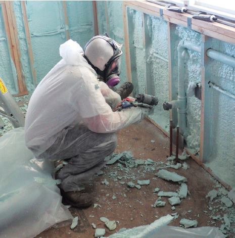

The wall is framed with 2x4 studs 16 inches on-center and is sheathed with Zip System OSB panels taped at the joints for airtightness (A). The stud bays are filled with open-cell spray foam insulation. (The original spec was for blown cellulose, but the local insulation contractor charged less to install foam.) Over the sheathing, we applied two layers of 1.5-inch foil-faced rigid polyiso insulation, for a total-wall R-value of 44. We fastened the first layer with 2-inch roofing nails and fastened the second layer through vertical strapping using 6-inch screws with 1 1/2-inch fender washers.

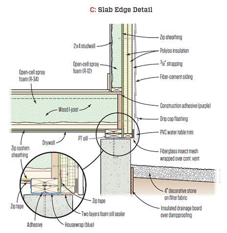

Because the farmhouse basement is to be used for cold storage and washing of farm produce, we thermally isolated it from the conditioned living space upstairs by insulating the first-floor joist bays with spray foam insulation. We made the basement ceiling airtight by screwing Zip sheathing to the underside of the floor joists and taping the seams (C). Connecting that airtight floor to the wall system was tricky. We laid a wide strip of Tyvek housewrap down on the foundation sill before framing the floor. After the framing was complete, we taped the Tyvek to the wall sheathing and to the underfloor sheathing with Tyvek tape.
“Avalon” has a full concrete basement that is not conditioned because it serves as a workspace and a storage facility for the organic farm. To isolate the working basement from the living space above, the first-floor joist system was insulated with spray foam and sheathed on the underside with Zip System sheathing, taped at the seams. This sheathing is connected to the Zip sheathing on the outboard face of the exterior wall frame with a strip of Tyvek. The crew sets the Tyvek down on top of the basement wall early in the construction process, before placing and anchoring down the pressure-treated sill. After the floor and walls were framed, this Tyvek was taped to the underside of the basement ceiling and to the face of the first-story wall frame using Tyvek tape.
