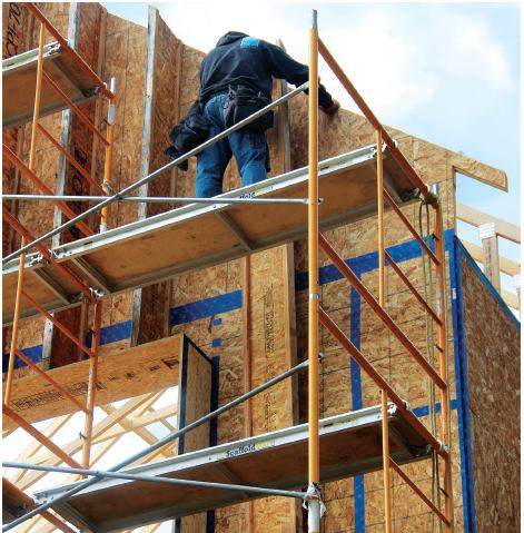

The wall system shown here is an improved version of the system I used for the house I built in Knox, Maine, in 2011 (see "An Affordable Passive House," JLC May/12 and Jun/12). Since building that prototype house, I've switched to some advanced European materials for air-sealing and moisture management that weren't on the U.S. market back then.
We start with an inner 2x4 stud wall, sheathed on the exterior side with OSB (A); all joints and nail lines are sealed with Pro Clima Tescon Vana tape (foursevenfive). The OSB layer is airtight, and also braces the structure. Next, we fasten 11 7/8-inch wood I-joists to the outside of the walls, driving 4-inch GRK RSS structural screws through the flange and OSB sheathing into the studs. As a weather barrier over the I-joists, we apply a vapor-open waterproof fabric from Pro Clima called Solotex Mento Plus.
EcoCor’s wall system is based on a simple stick frame with OSB sheathing, which then gets wrapped in an outer blanket of wood I-joists. The inner frame’s sheathing is taped at joints and nail lines. After the house is framed, sheathed, and roofed, the I-joists are screwed into the wall studs. (We typically use 12-inch I-joists, but on some projects have upsized to 16-inch I-joists.) Both the I-joist cavities and the inner stud walls are filled with dense-blown cellulose insulation, for a total wall R-value of about 56 (not including membranes). The system is airtight at the plane of the OSB and is vapor-open to the inside or the outside.

We double strap over the fabric to create an air space behind the siding. For vertical siding (barn boards or shiplap), we apply vertical strapping along the length of the I-joists, then horizontal strapping for nailing. But if the plan is for horizontal siding, we first nail horizontal strapping across the I-joist ribs, then apply vertical strapping for nailing. Finally, we fill both the inner 2x4 wall and the outer I-joist assembly with blown-in dense-pack cellulose insulation for a total wall R-value of 56.
