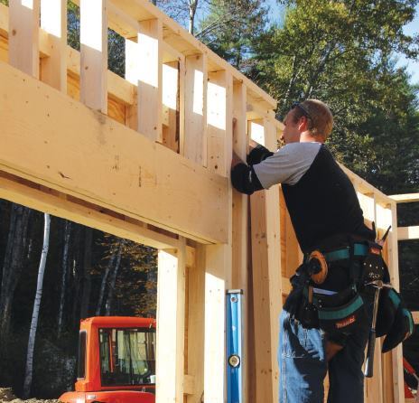

We chose the simple double-stud-wall method for this house mostly because of budget issues. The interior 2×4 wall, framed at 16 inches on-center, supports the first-floor frame and roof system (A). It is tied to the outer wall frame with 4×12-inch gussets sawn from ½-inch plywood and is x-braced with metal straps. The outer wall is sheathed with plywood, covered by a skin of Grace Ice & Water Shield. The 12-inch open cavity in the wall is filled with blown-in dense-pack cellulose (R-43).
