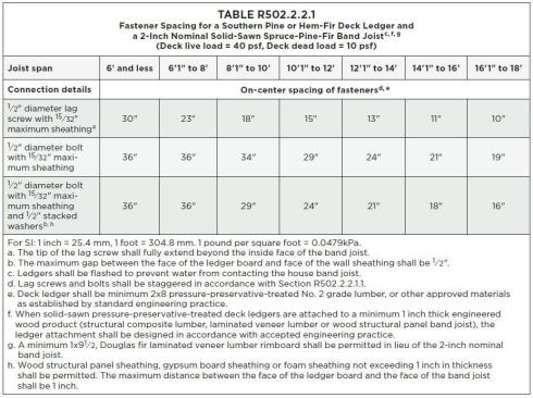

Ledger Bolting Schedule
Although the 2003 IRC finally prohibited the use of nails to secure deck ledgers, it lacked a prescriptive bolting schedule. That’s why, 10 years ago as a deck builder, I could use one 1„2-inch lag screw every 16 inches no matter the joist span, without being questioned. That’s changed under the 2009 code. Section R502.2.2.1 provides a simple way to determine the size and number of bolts or lags required and includes an easy-to-read table with footnotes. The fastening schedule is based on joist length, which determines the load in pounds per linear foot that can be expected at the ledger. Longer spans or conditions other than those addressed by the table may require engineering. (If you look at the table, you’ll see that the bolting schedule I used for the 1„2-inch lags mentioned above is adequate only for joist spans of 12 feet or less.)
Though this table does provide a clear way to design ledger connections, make sure you take a good look at the footnotes and the specifics in all the subsections of R502.2.2. For instance, the bolting schedule is intended only for uniformly distributed loads. Joists that carry other loads to the ledger – like a doubled joist running from the headered opening for a stairway – create concentrated loads on the ledger and will require some thought from you and the code official. When you calculate the tributary load from that doubled joist, for example, you might find that you need to use a tighter fastening schedule for that section of the ledger or make some other accommodation for the load.
Note also that you have to use a minimum 2×8 pressure-treated ledger. For builders who prefer to leave a drainage space behind the ledger, rather than flashing the siding over the ledger, the code allows for a 1„2-inch gap between the sheathing and the ledger – enough for a 1„2-inch stack of washers.

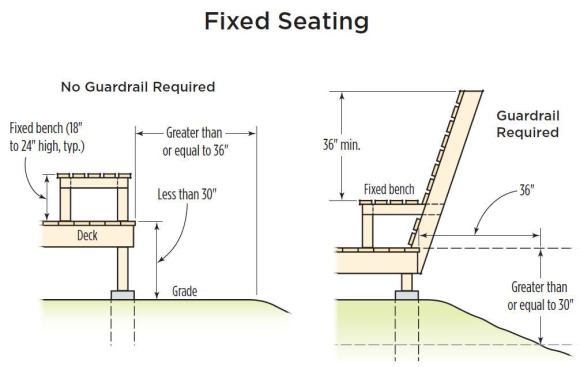

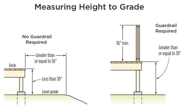

Height at Which Guard Railings Are Required

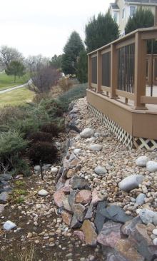

In the past, guardrails could be dispensed with on all decks no higher than 30 inches above grade. That rule hasn’t changed, but now the 30-inch height must extend at least 3 feet horizontally away from the deck.
Previous code editions referred to “grade” only as the height of finished ground level “adjoining the exterior walls.” That could be interpreted as grade at the deck posts, even if the posts were a foot away from a cliff. This loophole has been closed in the 2009 IRC, in Section R312.1. Just as you need a 36-inch-deep landing in front of a door at the top of a stair, you need the same area at the edge of a deck if you wish to forgo the guards. That is, the height of a deck must be measured vertically at a point 36 inches horizontally from the edge of the deck.

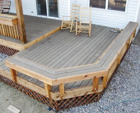

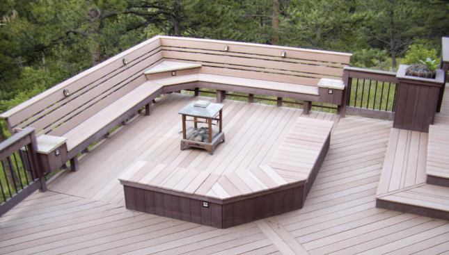

Guardrails at Built-In Benches
In the past, the required guard height was measured from the deck’s walking surface, even if there was seating built into the guard. Under the 2009 code (Section R312.2), if the deck has built-in seating around the edge, the 36-inch guard height must be measured from the seat. This addresses the concern that children will climb on the seating and be at risk of falling. Many of the built-in benches I’ve seen have backs that are only about 18 to 24 inches high – perhaps not enough to prohibit one of those little ones from falling over.
Interestingly, the new rule doesn’t mean that the height of the seat as measured from the ground dictates when guards are required. So if the deck surface is 29 inches above grade – lower than the 30-inch guard cutoff – you can still have a bench at the edge of that deck, with or without a back, even though the seat will be well over 30 inches above grade.
As someone that loves built-in deck features, I can’t say that I agree with this new provision. Children should certainly be protected, but it’s hard to see the point in regulating fixed seating when there’s so much movable seating on decks. It also seems that if 36-inch rails are adequate to protect adults, a lower height – for children – could be specified for bench backs.

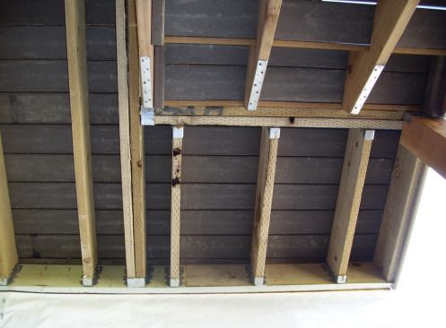

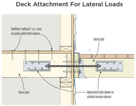

New Hardware Suggested For Lateral Loads

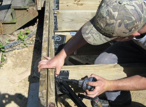

I saved this item for last because it’s quite controversial in the deck-building industry. In the past, lateral loads on decks were rarely addressed. But in the last decade, a number of incidents have occurred in which live loads generated by people on decks produced dynamic lateral loading that caused well-attached ledgers to pull the band joist of a home straight from the floor system. Most often, this happened when the band joist was cantilevered over the foundation wall. As a result of these accidents, some code-change proponents introduced a provision for addressing lateral loads toward the end of the 2006/2007 code-change cycle, when the ledger schedule was being discussed.
This provision, R502.2.2.3, has a number of problems. One is that it addresses lateral loads with a hardware detail adapted from a FEMA document actually intended for seismic loads; it uses horizontal hold-downs and long-threaded bolts to bypass the band joist and connect the deck joists directly to the home’s floor joists. Another problem is that it gives no consideration to the magnitude of the loads; it prescribes two hold-downs for any deck, regardless of whether it’s 100 square feet or 2,000. There is also a required nailing schedule for the subfloor on the joist above the hold-downs that makes it difficult and expensive to retrofit in an existing home.
The code language states that the detail is merely “permitted,” although inspectors in some areas are interpreting this as a minimum requirement. That’s making a lot of builders unhappy, though no doubt it pleases the hardware manufacturers.
In my jurisdiction, we are not enforcing this requirement because we make sure that decks are properly built to withstand lateral loads without resorting to this troublesome detail. For example, a well-built low deck with its pressure-treated posts sunk into the concrete piers can resist lateral loads. Also, the American Forest & Paper Association’s DCA6 Prescriptive Residential Wood Deck Construction Guide provides pre-engineered knee-bracing methods that will resist lateral loads, though they are not intended to be equivalent to the IRC anchor detail and would need approval by an inspector.
Despite its drawbacks, the presence of the lateral load connection detail in the code has put the question clearly in the face of all deck builders and code officials: “How are you resisting lateral loads if not by this detail?” If you don’t provide an engineered design, the code official will likely take a hard look at how well the ledger is attached and what it’s attached to.
