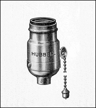

Enter Harvey Hubbell, an avid inventor who had already filed numerous patents, including one for a switch for the Edison bulb in 1891 and ones for improving the production of screw threads and for slotting screw heads. His first runaway success, however, was an 1896 patent for the “pull socket” (essentially the same pull-chain switch used today), which soon became the most common electrical control device in homes.
Hubbell’s “pull socket” (patented 1896) was the first common electrical switch.
Hubbell Electrical Catalogue, 1906 Hubbell’s “pull socket” (patented 1896) was the first common electrical switch.
