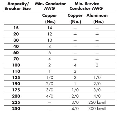

Ampacity
The ampacity of a conductor is its current-carrying capacity, which is a direct function of wire gauge. The 14-gauge and 12-gauge wire used in most residential branch circuits can handle a maximum of 15 and 20 amps, respectively. Large appliances, such as stoves and dryers, use larger diameter wires. Exceeding a wire’s ampacity can lead to the overheating of conductors and may cause a fire. The maximum ampacity and circuit breaker size allowed for common conductor sizes is shown in the figure below.
Note: Entrances of 50 ft. and longer may require larger conductors to compensate for voltage drop.
Wiring in branch circuits should be sized so the voltage drop does not exceed 3% from the panel to the farthest load (Maximum Recommended Length of Branch Circuits, below). Exceeding these runs can make devices run less efficiently and puts stress on motors. Voltage drop will also cause the conductors to heat up slightly and will waste electricity. This can be a concern for long service entrance conductors. If the meter is installed remote from the house, a customer will be paying for the electricity consumed by voltage drop. Studies have shown it is cost effective to upsize service entrance conductors to alleviate voltage drop. The added cost of the conductors will be offset by savings in the electric bill.

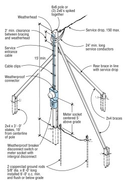

Temporary Service
New construction often requires a temporary electrical service to provide a location for circuit breakers and metering equipment during construction.
Temporary service is usually rated at 100 amps and, like the permanent variety, can be either overhead or underground. Most utility companies will not run an overhead entrance cable more than 100 ft. from a utility pole. If the attachment is overhead, a cable or conduit riser must be run up a suitable pole or post to the minimum attachment height allowed by the electric utility (below).
Temporary power pole specs are often enforced by the utility that supplies the power. The required double mast protection — conduit and wood covering — may seem extreme until the first time a backhoe slams into the pole. Extend the pole’s height to 18 ft. if it is installed over any areas that receive motor vehicle traffic.
Enclosures for meters and circuit breakers must be rated as weatherproof. Units with both the metering and distribution panel in the same box save time in field assembly. Temporary services must be grounded at the enclosure that holds the main disconnect breaker or fuses. Two 8-ft. ground rods, 6 ft. apart, must be driven into the ground and connected to the service’s grounding terminal with a No. 6 copper ground wire. The ground wire must be attached to the ground rod with a clamp designed for that purpose.
