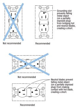

Receptacle Orientation
Although it’s not a code requirement, many electricians orient receptacles so that if a metal object (such as a loose metal cover late) falls while something is plugged in, it will land on the plug’s neutral or grounding prong, rather than on the hot one (below).
